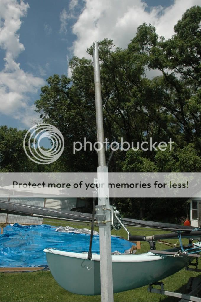

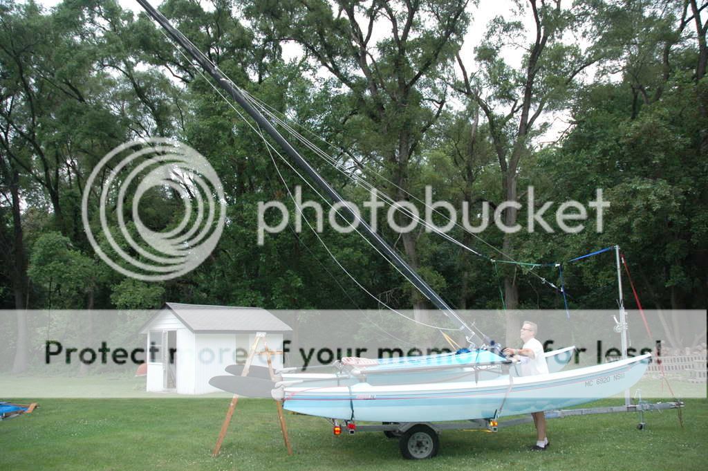

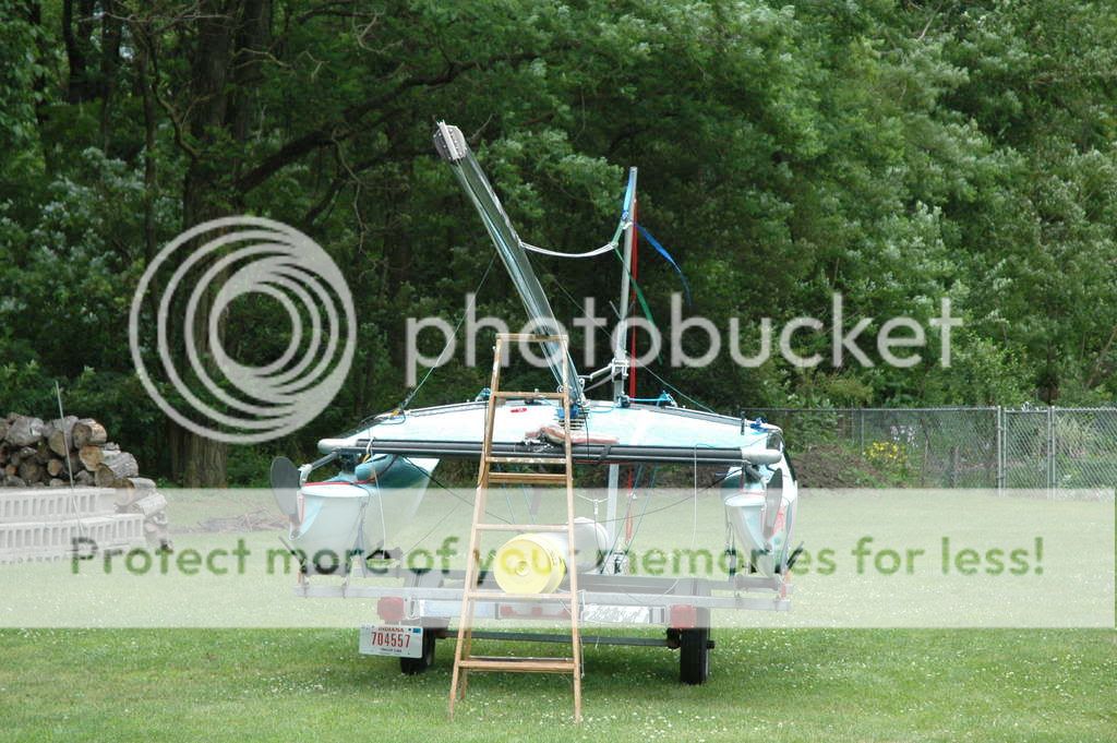

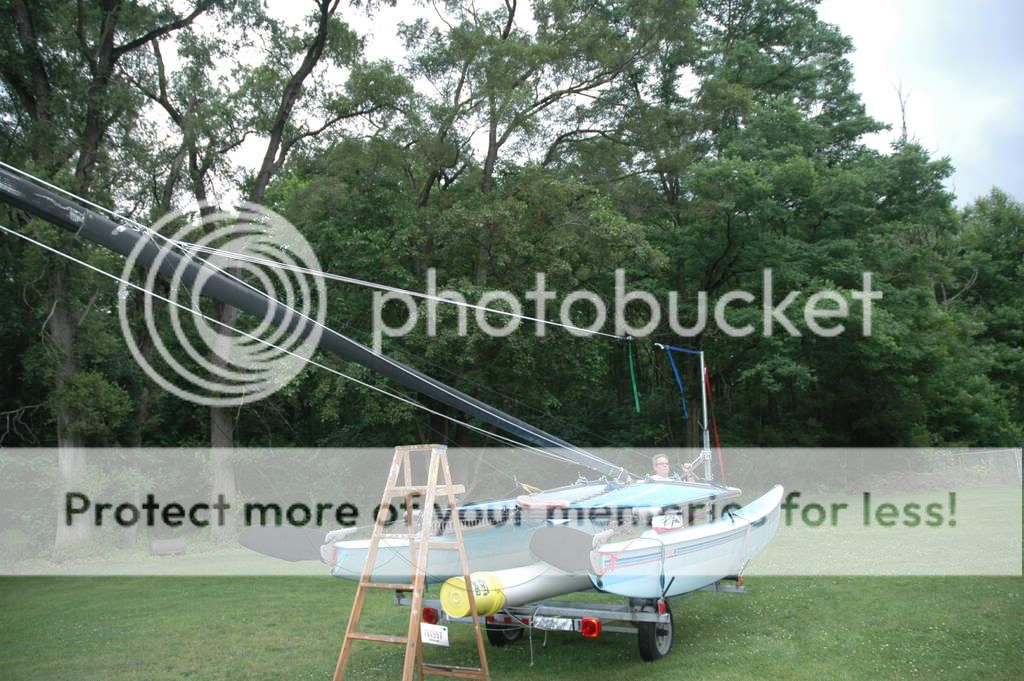

Well I did it today and I found out that you need some slack in the connection to the trapeze wires. I will most likely use the bungees and a nylon strap as shown in these pics in case the bungee would break. My set up is crude but I just used what I had. I started it up with the halyard and finished with the forestay and the wench. The weather was beautiful and I was going to take it out as soon as I had it figured out. Then the rain came. I need to make a mast prop to hold it in position and I need to do away with the cushion and make a mast cradle. Thanks for the replies they have helped greatly. Well I see that pics are not straight forward I will have to do some reading to learn how to post with photos.

Heres the pics This is not complete and was done with what I had laying around the house. I cheated and used the winch once the mast was up high enough. I will post more pics when I am done. thanks for the ideals!
