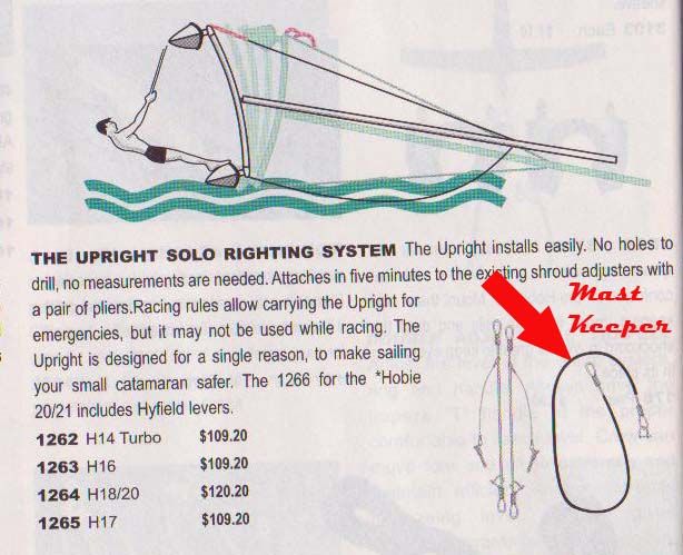

My new boat came with the shroud extenders but missing the white plastic coated leash for mast. It appear that it goes through the downhaul cleat around front of tramp and up to shackle onto mast foot, using holes for mast stepping device. If that is correct would you have any idea of the length of this piece of braided steel cable. Any additional pictures or mounting advise of the strap would be great

whered you attach the bottom of the wire on your mast, i see it runs through the cleat, where does it go from there?

Hi could you please inform me of the lengths of the shroud extender cables as well as the mast safety wire.
I am based in the UK and the cost of shipping these over is rather expensive, well i should really say extortionate, but I do have access to a wire rope crimping machine :-)

Just got a hold of one of these. Mast safety wire is 37 1/2" from the tip of the thimbles. Shroud Extenders are 14" tip to tip. Should be pretty easy to make and then just order the quick pins. The shroud extenders use a thicker wire than the mast safety wire. I don't have a thickness gauge here but I'd probably say the shroud extenders are about 4mm in thickness. They appear to be the same thickness as the shrouds and the mast safety wire would be one size down, 3mm?

Just wanted to add a success story with shroud extenders...
I made a complete set with mast keeper based on the pictures from Hobie and the description above.
Refer to a great diagram here:
https://static.hobiecat.com/item_attach ... 263z52.pdf
I made sure that the mast keeper was pretty tight while letting the mast rotate. I wish I'd made it a tad longer than 37 1/2 though... I may make a new one. The first time I attached it I adjusted the downhaul cleat to ensure the keeper is snug.
