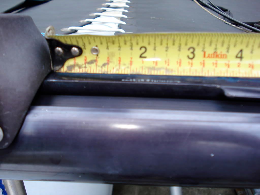

Got a chance to measure mine this morning, sorry the pictures are not the best it was freezing cold and spiting snow, I mean rain. Boat is a 2004 worlds boat.
