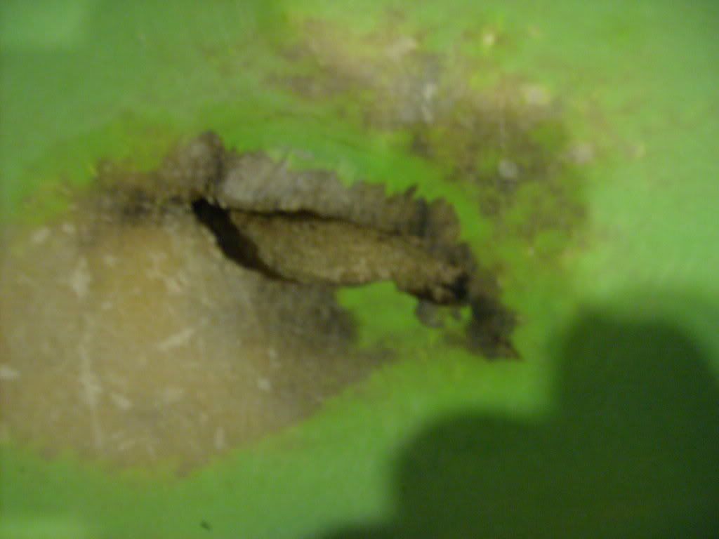

GOOD STUFquestion time for Jeremy.
I have read on several dif. forums about hull repair and it seems you just mayhave done one or two, the question is the teqnique where you fashon a patch on wax paper and thread it through the hull hole or break then hold in place w monofiliment to (relam) over it . finish and gel.
would you use it on the dammage here? I have 2 H16 with the same trailer bite!
and I did buy them this way....one was covered with bondo the other with tape and paint.[img]http://i1203.photobucket.com/albums/bb394/rwl1967/SANY3446.jpg[img][/img]http://i1203.photobucket.com/albums/bb394/rwl1967/SANY3449.jpg[/img]
thanks rich

For your repair you need to grind that skin a little more, get rid of the rotten foam, and check the inner skin for damage. This is the part of a repair that will help you determine how to properly engineer the repair.
You want the inner skin to be solid and glued to the foam, and the foam to be solidly glued to an outer skin. You're going to be laminating the outer skin on the outside of the hull, but you need to taper the edges. Like this:
A taper ratio of 20 to 1 works well for Hobie hull repair. Up to 50 to 1 for areas that will encounter more stress. Standard is 12:1.
I like Rick's well-documented trick with the mono-filament, but I always have a difficult time getting good, solid adhesion. I'll describe how I do it below. (Someone can post the Hotline article.) This method is generally only used on a spot where the glass is solid...with no foam underneath. Where there IS foam, you need to glue the skins back together to regain the proper structure. Any part of the hull structure that isn't bonded together, is damage, and should be ground away.
1) Grind out the outer skin and rotten foam, leaving the inner skin to use as a flange.
2) Laminate the new piece of glass on wax paper, or a flexible piece of plastic like a bondo board. Don't use PVA, as you want it to stick to something eventually.
3) Now, since you're ADHERING the new piece to the inner skin you want to use vinylester mixed with a good thickener to make a putty. You could also use Epoxy, but be careful not to get any on the exposed area. You don't need to glue it to the inside of the hull if you're in a spot where there's foam, glue it on the outside of the inner skin.
4) Fair it. Re- foam the core. Laminate the outer skin, hotcoat with gel and you're done.
You can do this!

Ok, I understand to remove the bruise...delam and to feather and expose plenty of old glass to adhere to.
I understand the patch building.
re-foam..you lost me there.
and re-laminate on the outer side I understand.
with no foam do I putty gell adhere the patch directly to the GOOD inner
ply then build with glass mat and resin
or do I make a hollow sandwich and finish like the old tub buggy?
If I am to fit foam where is a sourse via the net.
thank you Rich

First, your boat is a foam core sandwich. Skin-foam-glass. Capiche?
I am assuming that there is damage to the inner skin with a punch like that. Maybe, maybe not, you have to investigate. You want to grind the outer skin away until you get to where the foam is bonded to the core. Your foam looks really bad anyway, so not much loss there.
Use a Dremel Tool or something similar to grind the foam away in order to inspect the inner laminate. Don't nick the inner skin. You're just inspecting it still at this point. If the inner skin isn't damaged, use some Divinicell Foam or just mix a slurry of resin and microbaloons, and replace the core. That's what I mean by re-foam. The core gives the hull structure. The distance between the skins is the strength.
http://www.jamestowndistributors.com/userportal/product.do?part=42743&BASE
Does that answer your question?
