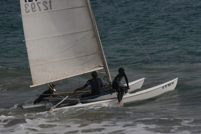

After successfully assembling the boat (forestay to the dolphin striker, bypassing the hardware), we beach launched for the first time. To keep things simple we went with only the mainsail. I had reservations with launching, but it went smoothly and we zipped out about 30 yards with the wind.
Then came our trouble- we could not get the wind (over 14 kts) to catch the sail, perhaps it was because as soon as we would the rudders would swing and throw off our course. Seeing as two of us have sailing experience we never thought that this would be the problem and after trying many different methods we ended up having to swim her in, again- without issue. SO... we were able to do EVERYTHING but sail the damn thing. Does she look like her hulls are too deep in the water? the tiller felt very loose, not sure how they normally feel, but that might have been an issue too. Thoughts?
Clearly, we need help.

I can't quite tell from the photo where you're underway, but are your rudders locked? If your rudder cam has been locked when the rudder is up, you won't be able to get the rudders to correctly lock down.
PostPosted: Fri Aug 29, 2008 10:35 am
Joined: Mon Feb 25, 2008 1:42 pm
Posts: 80
Ditto
From the photos, it appears that the angle of the tiller extension etc is too high - so presumably the rudders have not locked.
Would seem that the main is not raised fully - has not engaged on the catch on the mast.

SicosDave wrote:
Ditto
The rudders were locked in the down position after we pushed off. The tiller extension seemed normal to me in positioning, but very easily moved with minor chop.
So the two prevailing theories as to why our mission 1 failed are:
No jib.
Possible rudder issue (though I am inclined to think that the rudders were locked as we put them in place after launch).
Would either of these isues prevent us from catching wind?
