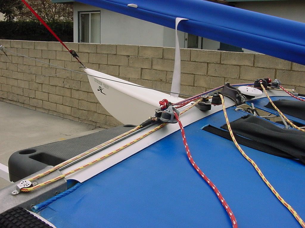

You mean, like this???

I like the kit David showed a picture of the best when converting an older boat.

What's that white disc shaped doohickey to the side of the mast step?
PostPosted: Wed Dec 10, 2008 5:06 pm
Authorized Hobie Dealer
Posts: 1369
compass mount?

I thought it seemed kind of big for a compass mount.
PostPosted: Thu Dec 11, 2008 11:44 am
Posts: 740
Location: Los Angeles
You're right Dog. It is a compass mount and it's just the right size.
I can see it from anywhere on the tramp and from most places on the wire.

Brad was right...
That's one BIG compass.
PostPosted: Thu Dec 11, 2008 2:02 pm
Posts: 740
I got this one at West Marine. They make them larger (like the ones on 505s and some of the other smaller monohulls ) but they were a little too expensive for my taste. It works great. Some people can sail strictly from instinct. I've only been sailing for 6 years and I haven't quite developed the knack for that yet. Sometimes I can (when I'm really feeling it ), but most of the time my sailing is information based (compass, wind-vane, tel- tales, e.t.c.) I guess I trust the information more than I trust my sailing skills. As I understand, ther are advantages and dis-advantages to both. That's really weird because everytime I've capsized, I was relying on information. I have never capsized (or pitchpoled) while sailing under instincts. Things that make you go Hmmmmmmmm. :?
