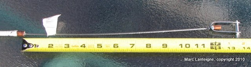

So, when I bought my H16, the steel wire section of the halyard was too short. It measured about 11" and was missing a bit more than an inch to be able to lock it in the fork.
So I bought a new one from the closest dealer and sent me an H16 comp-tip halyard, but as you can see from the photos, the steel wire section is too short.
Do they make one with about 15" of steel wire? If so, anybody have the part number?
Thanks,
Marc...
Marc...

The old style all aluminum masts used a different halyard. I believe the Hobie part number you are looking for is 20651011 for the main halyard assembly.

Confirm. That in fact is the incorrect halyard.

I knew that much, but it's always good to get a confirmation from a reliable source. Would the right one be part #20651011?

That number would be correct. The halyard for the all aluminum mast has a much longer cable. The comptip halyard has the short cable

Thanks. I'll return this one for the right one.

That PN is correct for the correct one.
