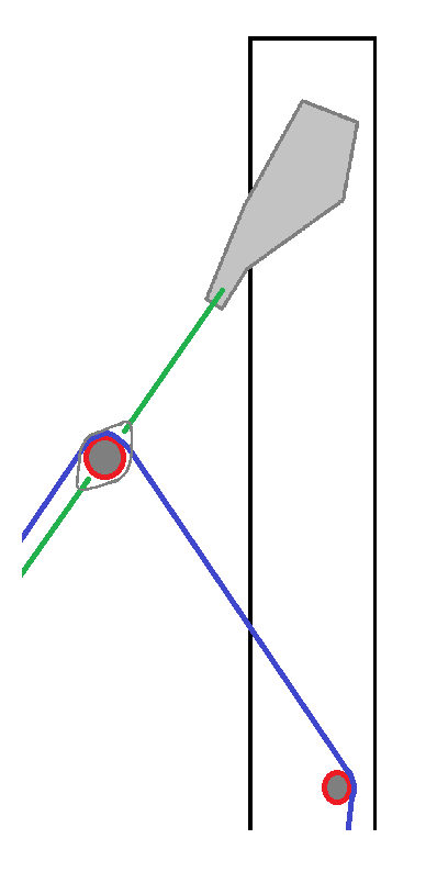

 Post subject: Re: Setting up the Mast
PostPosted: Wed Aug 31, 2011 10:41 am
Posts: 15100
No. The main halyard load is held at the top by the halyard hook. If you want to route the line aft to keep it from tangling the jib battens... walk it out and aft of the shroud, then tuck under the downhaul cleat... then tie to the halyard cleat. That routes it well back on the mast and away from the jib battens to prevent tangling during tacking.
