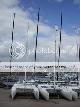

I had heard of attaching fenders. I took this pick in France last month. I am trying to rember the model of Hobie cat - Avalanch maybe?
