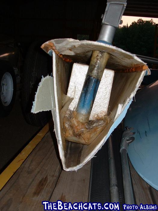

Hi there. I had an unfortunate accident a few weeks ago, sailing along in my Hobie 16 when the starboard side hull decided to go in a different direction :P I found out that the previous owner had obviously had a similar accident in the boats past life as he had repaired the rear right pylon by putting a wooden insert inside the pylon. A few years that repair obviously rotted and gave way. Not so good. Anyway my plans are to replace both front and rear pylons. Can anyone give me any hints on how to get the old pylons out of the hull without smashing big holes in the boat? Any help would be greatly appreciated. Cheers.

You cannot do what you want to do for less than the cost of a used replacement hull.
Even if you could, you'd need to cut several access holes.
This is what you're up against:
It's glued at the deck and swaddled in glass at the bottom.

Ahh right looks like a major. What do you think about making an aluminium insert for the pylon and then just adding a new bit of mast section to replace the broken part at the top of the pylon?
