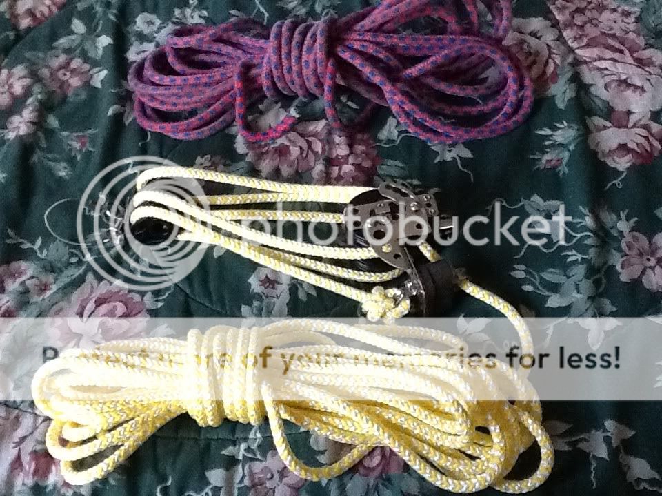

I went with Bzzz line. Just reeved it an can not wait to try it out. The original sheet is much stiffer.
