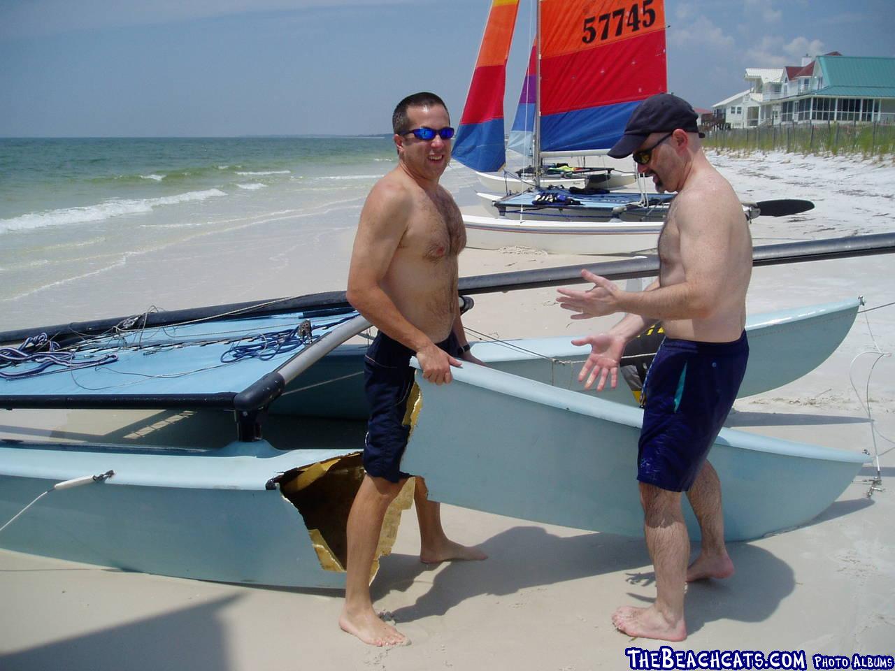

PostPosted: Sat May 19, 2012 4:23 pm
Joined: Mon Jan 03, 2011 3:42 pm
Posts: 274
Location: Sarasota Sailing Squadron
like this?
http://thebeachcats.com/pictures/?g2_itemId=48151
http://youtube.com/optikid16030
1983 Hobie 16 Cat fever #55697
2008 Laser Radial/4.7 #190471
S.S.S.
S.Y.S.P

That is the same color as my 1980 hulls !
I had better paint them real quick !!!
ha ha and Thanks for the heads up !!!!!
