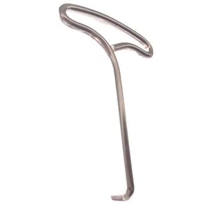

Buy a $5 hockey skate lace hook and use it along with a vicegrip. Makes it *much* easier to tighten the lacing and saves your hands.
