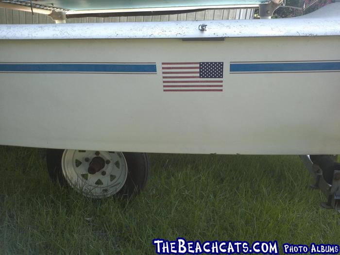

Since I don't have the sails, can anyone (MBounds) verify that the hull graphics for the Spirit of 76 package were like mine? These look like factory stripes to me.

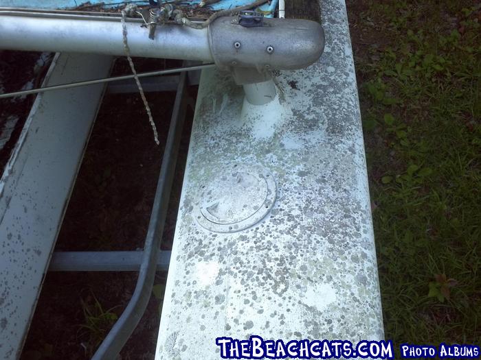

Someone put a hull port in a kind of odd place.

A quick search of the archives turned up a couple of photos that seem to confirm - that may be the original hull stripe, although the US flag is a later addition.
In general, hull stripes didn't become common until the late 70's - the Red Rocket, Blue Streak and Keoke patterns had appropriately colored triple stripes like the one in your photos, Damon. I didn't think they were on boats as early as '75 when the Spririt of '76 pattern boats were made. These photos were from 1975 / 1976 Hotlines. You can't really tell the colors, but the stripes are lower on the hull than later stripes (matching yours) and the fact that the "Hobie Cat" applique is on top of the stripe seems to confirm its originality.

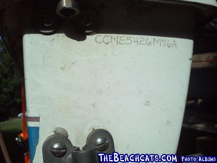

Thanks, that's great, that's probably about as much confirmation that this was a Spirit of 76 boat as is possible. Short of actually looking up the HIN number in Hobie records. I'm guessing those kind of records don't exist?
I like the flag, if it's not original someone did a really good job trimming the stripes and adding it.
