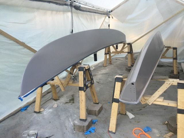

sanded faired and ready for paint
5 coats of gel coat later.
wet sanding 800,1000,1200 followed by compounding and waxing left.
