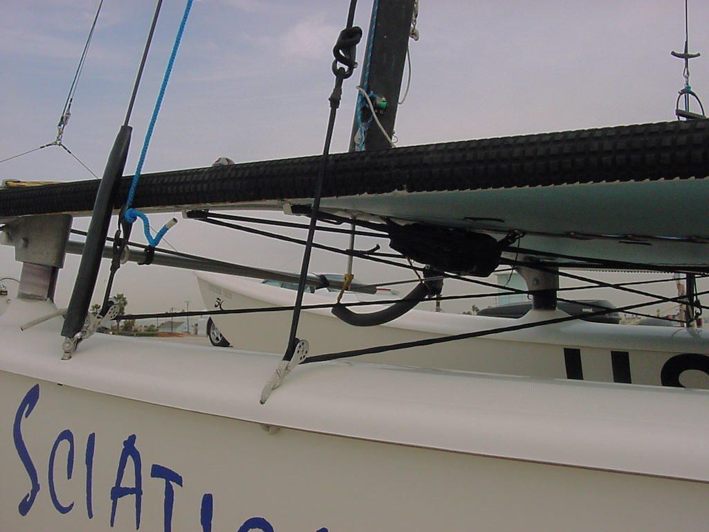

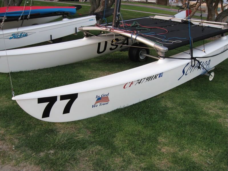

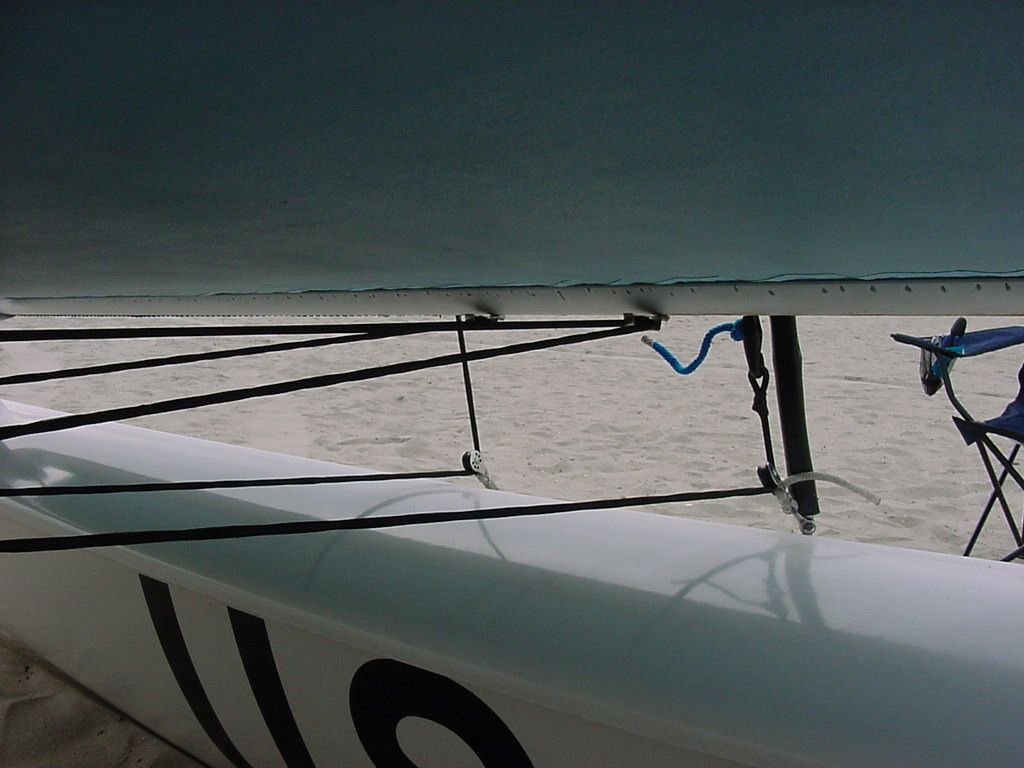

Hey Bill..... These are pics of that system. The trap lines are held at 2 inches (+ / -) from the side bars which eliminates the wear on the rail rug which occurs when trapping out. Additionally, it allows for trapping out off the stern without the resistance of being pulled forward that occurs when using the traditional trap return system. I know this might seem like overkill but it makes sailing a lot easier, especially if you sail solo a lot !!! It also makes your boat a lot easier to rig, as the trap return lines are already affixed in place under the trampoline !!! :wink: :wink: :wink:
To XXRRacer: In this pic below, I used the material (the black strip just fore and aft the foot strap) you referred to on the stern of each hull. It works really well !!! :D

Are you using cheek blocks attached with a single rivet under the tramp rail?

Wow, how cool, thanks for sharing, I can do the rigging having seen it, but I doubt I would've ever came up with such a great idea, I can't wait till spring!

Yep, Bill !!! That's what they are !!! I used mini-blocks at every turn of the line. It makes coming in and going out a smoooooooth transition !!! :lol:

Sorry, but this wasn't all my idea !!! The extended bungees was Hobie's idea but they were run inside the side rails and through the trampoline. I thought it was a great idea but it just didn't meet all my needs. After studying the concept for a while, I came up with the modified version which turned out to be a perfect fit for me. It did everything I wanted it to !!! :D
