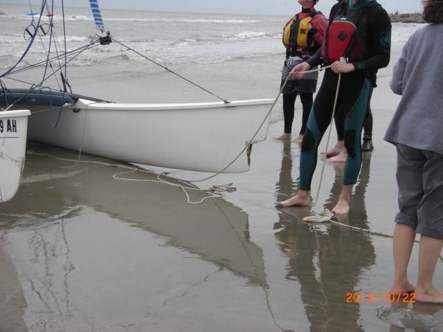

I would recommend against ever using the fiberglass rudder pins. I saw the carnage caused by one breaking at a very inopportune time at a H18 race. Port-Starboard crossing, port boat pulled hard to duck starboard boat. Brand new fiberglass rudder pin broke. Port boat T-boned starboard boat. This was the result:
