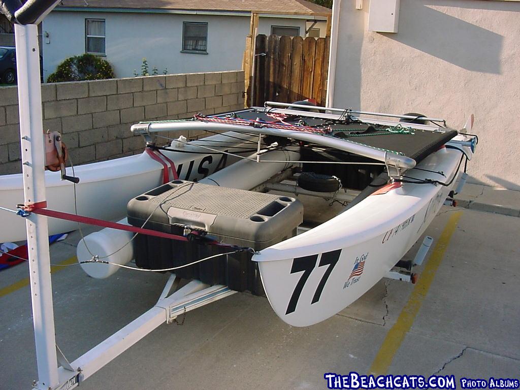

OK so, a Bill404 War Wagon is one way to go. (I love it. My projects often grow wildly out of control too.) Or, if you'd like to go light and inexpensive... I have a 14" plastic corrugated pipe with sheet metal end caps that are held on with bungee cords though small side holes. To open; just pull outwards and lift up and over the pipe. The caps sit up there attached.
One cap was missing when I bought the boat/trailer combo and a local heating and plumbing shop just made one up to match, for $27 incl. tax. The pipe diameter is odd at 14" but I like it! The extra room makes it easy to get stuff (rolled sail, boom, etc...) in and out from either end. Pipe is best purchased from a pipe supply yard... ask for the odd lengths pile to sort through. Pipe comes standard in 20' lengths but at times it is ordered in a short section and they just cut it off. Takes a while to sell the short stuff so... discounted, you win. I would suggest that you can get enough of a bargain that you could even buy a coupling to join two very short sections and still be ahead.
I thought of making a plywood door at one end but the weight and, prospect of sand in hinges, etc... made me look to a fabricator.
