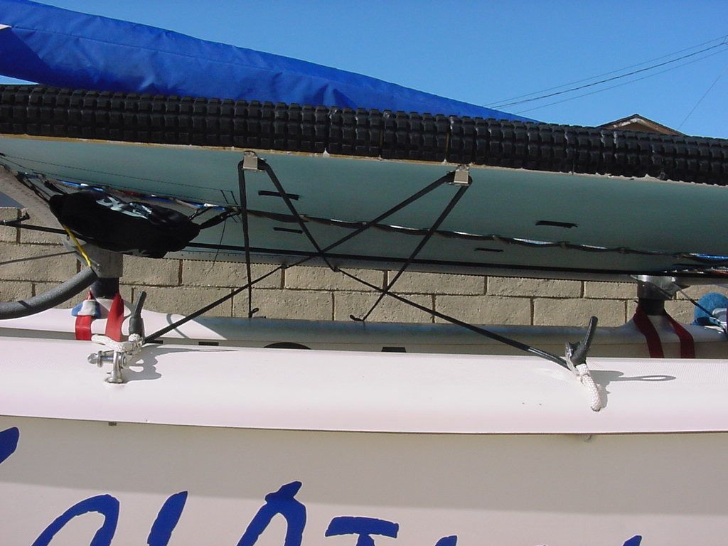

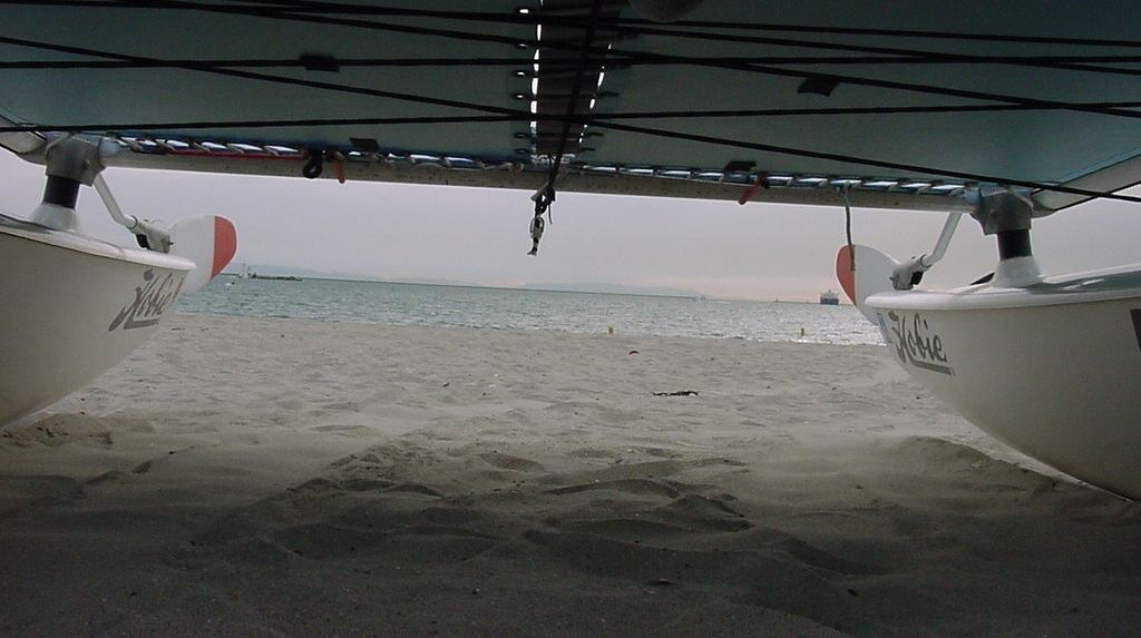

I don't know if the trap-return system is illegal or not but it's never been protested even though I was told that the single hole drilled in the lip of the hull is in violation of Hobie Class rules. Anyway, know that my overkill trap=return system design has multiple functions. It not only saves wear-N-tear on the rail-rug but also makes the boat simpler to rig and enables the skipper to go further aft on the stern when trapping out without the bungee pulling you forward. I know it looks complexed but once it's done, it's done !!! Also know that my system uses mini-blocks, minimizing the wear on the bungees. The boat was configured to be rigged single handedly and this system cuts about 10 minutes off the rigging time !!! Good luck with your decision. :)

No, but seriously !!! If you set it up the seemingly complexed way, you'll never have to be concerned about your trap return system again. You set it once and that's the way it stays, for life (unless you wear it out}. Then all you'll have to do is replace the bungee. BTW, the distance between the returns is relative. All of my crew members have been small so for me, it was 20 inches. Also know that the trap lines are color-coded. Black for the skipper and light blue for the crew so there's no confusion when it's time to go out. I'm kinda tall (6' 2") so my trap-line is a little shorter than the crew's. It's easier to pull up with an extended arm than it is with a retracted one. Have fun !!!

I didn't see a link to a prior thread so; It appears from you photo that your port crew's trap bungee, crosses forward to become the skipper's starboard trap bungee and, vs-versa on the other set. Is that right? And if it is; How does this facilitate the skipper moving further aft?

I don't think BboySlug would mind, seeing that your question is of similar subject matter. And yes, you're absolutely right (It appears from you photo that your port crew's trap bungee, crosses forward to become the skipper's starboard trap bungee and, vs-versa on the other set. Is that right?) except the crew's port trap bungee crosses BACKWARDS (three times) to become the skipper's starboard trap bungee and vs-versa.
Know that each bungee is more than twice as long (probably 3 times) as the bungee in the standard configuration. The additional elasticity allows the skipper (or crew if necessary) to trap out further aft without the bungee pulling them forward like it does in the standard configuration. Also know that even though that bungee is anchored about mid-hull, there's still enough tension so that everything snaps right back into place when coming off the wire.
