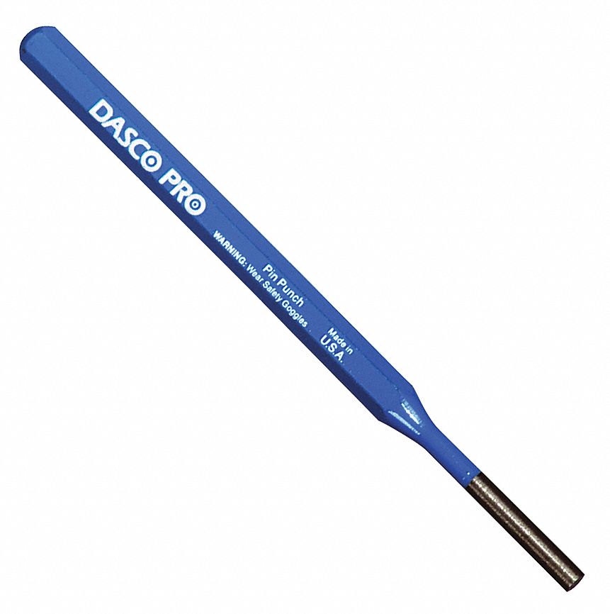

The pin in the mast step casting has to be removed. It is a "Flair" or "Press" pin and the end is being called the head... either end.
You need to use a drill (1/4" as I recall) and drill the flair material to thin it or remove it without drilling into the casting. Then use a straight (Pin) punch to push the pin out. You can also use an old drill bit or rod material as a punch.
