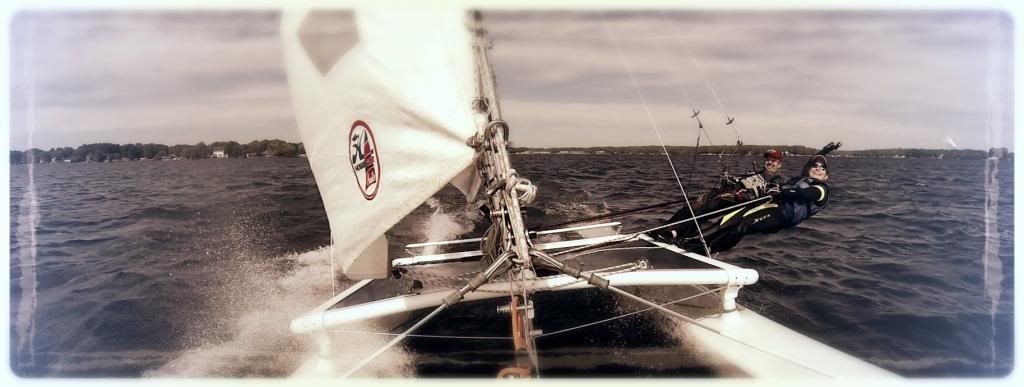

It was really blowing nice today for single-handing, 10-15 mph pretty steady from about 11am on. So, I grab my trap harness and set sail. I get out into the main channel and it's occasionally white capping with lots of dark water, winds from the SW. I'm ripping it up on some reaches, one eye on the leeward bow, no problem. Getting really comfortable now and showing off a little for the passers-by on pontoons, jet-ski's, etc. Nothing quite like flying a hull out on the wire solo, except when the mainsheet slides off the tramp to lee and you can't blame anyone but yourself. Then here come's the "Catawba Queen" dinner-tour boat loaded to the rails with paying customers. Show-off time! I move closer to the party yacht with blazing speed, spray misting out from the lee bow soaking the trampoline. Make a couple of passes to the cheers and hoots of the crowd, feeling on top of the world. At this point, it's the best sail of the summer. I bear off and take it easy for awhile to rest my stomach muscles. I'm feelling pretty satisfied and tired so I decide to head back to home. Still out on the trap I'm pinching the wind pretty much as hard as you can on a H16, bearing off just enough to keep the speed up. Then wham! Windshift! I'm dunked into the lake before I can react. First instinct is to loosen the main - can't it's jammed against the traveller, crap! I'm still snapped into the trap wire -can't move to the other side. It's all happening in slow motion and I know it's too late. Down she comes right over my head. I finally manage to get free from the trappeze and swim around to the other side to get up on the lower hull. Once up I do some reaching and streching to get my righting line, stand on the bow to swing the mast to windward and pulllllllllllll. nothing. Okay, lets try the shroud extension. I reach up and pop it loose, the upper hull is working with me now. Get her pointed back at the wind once more and leannnnn. Getting a little response now, a few bounces to get the mast tip up and the wind peeled that sail right up and out. I grabbed the dolphin striker as it came down and jumped back on board. re-attached my shroud, sorted out the lines and set off for the trailer. Whew, gonna sleep good tonight!
I never would have gotten her back over without the shroud extender unless I had some outside help.
The following video was taken some time later from my original post but thought it shows how good this works. And for anybody whos afraid they will demast, I think it's impossible with the mast keeper. In this video I actually had both extenders popped loose.

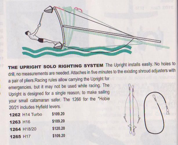

Straight out of the Hobie CATalog. not used for making shroud adjustments, only for temporarily disconnecting (extending) the shroud without an accidental demasting.

Ahhhhh thanks, I thought you were referring just to part 10049 Shroud Extender on page 18 of the current catalog. Appreciate the clarification Sebring. I can't totally tell how it works but it looks like 1263 and 10049 work together, is that right?
Funny, I posed a question about a similar technique using a trap line for righting on another thread believing it would offer greater mechanical advantage over the dolphin striker. I got several responses saying that trying to right your boat using the trap wire would be like trying to pick yourself up by grabbing your feet - Someone even threw in trigonometry. ??? With the solo system I don't see much mechanical difference with them both ultimately attaching to the tang. Check this out:
viewtopic.php?f=14&t=27599
Anyway, do you (or anyone) have pictures of the solo righting system installed, or even working?

It's not so much a mechanical advantage with the location of the mounting, the whole point is that it gets the hull that's up in the air past the vertical point and over to the side that you are on while standing on the lower hull. Now instead of using a righting bucket or an extra person you have the weight of the upper hull also helping you to pull the rest of the rig. I'll post a picture of the system installed later today.

I see you're not using the 10049 shroud extender gizmo, any reason why? Would it make single-handedly re-attaching the shroud line easier or unnecessary?
Also, on the nifty master keeper, is that the third line in the catalog?

Jman ~ A: Not using 10049 because I'm not sure if if would work in conjunction with 1263 and not sure how useful it would be. The master keeper is the third line in the catalog.
eric ~ A: Demasting is definately a possibility when suddenly loosening a shroud. That is the purpose of the (white covered) wire in the 3rd picture that wraps around the lower part of the mast and is secured to the base. It will prevent demasting in most circumstances (I did say most, not all...lol)
