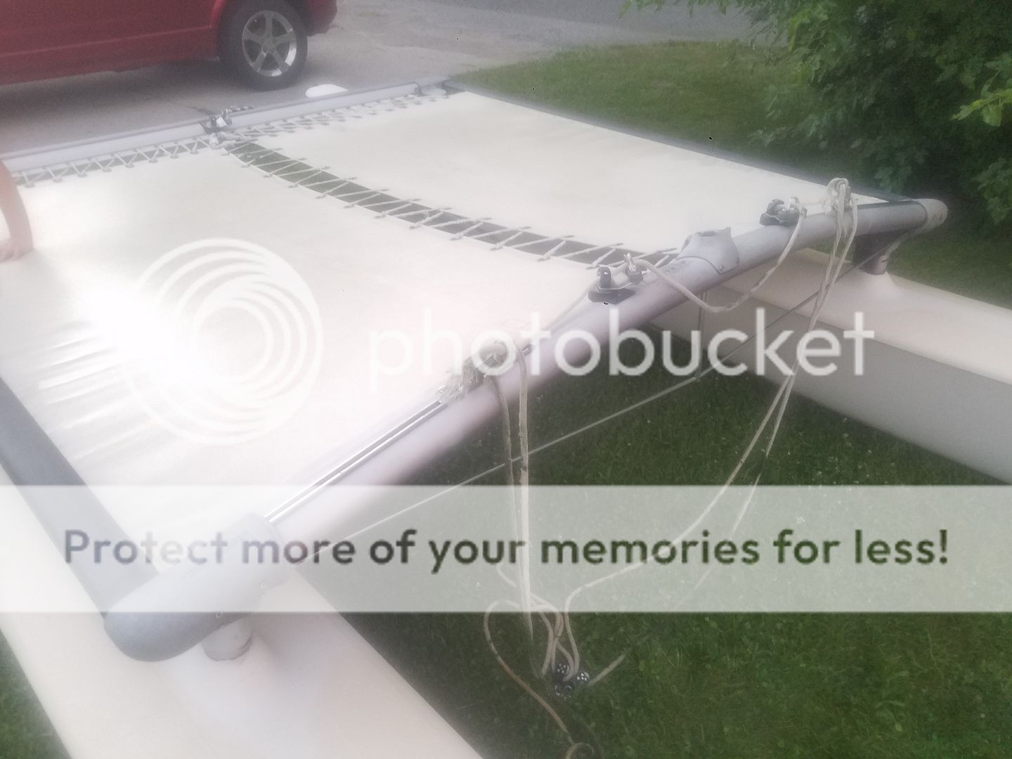

I recently purchased an '84 in order to replace my '72. I had new parts on the '72 so I just swapped them over to the newer boat, however the forestay takes some extreme effort to reach the top hole of the adjuster plate, even with two plates pinned together for extra length. On the old boat, I had installed the newer style shorter side shrouds, and had ground the step to accept the extra rake. Instead of buying the longer bridle wires, I pinned a 2nd adjuster plate to the front, and was always really easy to pin the forestay. The shrouds, mast, bridle wires, and double adjuster plate all moved over to the new boat.
I've been scratching my head trying to figure out what is different between the two boats, afterall, all of the standing rigging moved over from the old boat. I'm pretty sure the front crossbar on the new boat arcs quite a bit higher than the front crossbar from the '72. Just looking at it, from my memory, the crossbar from the '72 barely had an arc to it. I would assume once the mast step changed around 1982, in order to get some elevation on the boom, the front crossbar arc may have been increased to bring everything up a bit. I don't currently have access to the old boat to compare. Am I correct?

Well, that would normally be the case with the shrouds, but I've added an extension to the front so that it could reach easily. It worked perfect on my old boat, and like I said, every bit of the standing rigging, jib halyard, and mast moved to the newer boat frame. Only difference I can see is the arc on the front crossbar. As Matt said, it may be tensioned very tight. I will mess with it when I get home.
Here is a photo of it.... the arc is not as pronounced in the image, but in person, from a side view, it is pretty high.

Bend specification is measured from the lower edges of the beam which is inside the casting, so hard to do when assembled. It says 4 1/4" to the underside of the beam.
Striker spec says tighten until not loose... then turn nuts "four flats" (about a half turn I guess) on both sides. Just slightly tighter than loose.
Racers found that the flatter beam allows the outer sides of the hulls to be more perpendicular to the water... Better lateral resistance. That would be to a point... then the bows are splayed out to wide.
Maybe this would work to check... I have a measurement from the back sides of the posts, on center... measure the distance between the forwards and then rears.
78 1/2" front
77 1/4" rear
PostPosted: Thu Aug 08, 2019 10:20 am

This gives me a reference to start with. I will measure at the posts and see if I can match the given measurements. I should probably measure the bottoms of the hulls (center to center) at the bows, stern, and midway to see how close they compare. My fear is that it has been tensioned so far that it is beyond the crossbars ability to spring back the needed amount, but I guess I will see. Thank for all the info!

Okay, I'm under the assumption the point along the bottom of the hulls would remain parallel. I didn't have a lot of time to mess with it last night, but the striker rod was not all that tight. I loosened it all the way, the crossbar didn't budge, so I just snugged it back up. There is a little fore/aft movement with the striker rod and bar, but that should be normal from what I've read. I'm still going to measure just to make sure the front of the hulls are not pulled way in, but it's looking like I'm stuck with it this way. I'm going to try to compare the other crossbar over the weekend and see if any difference can be measured. I made a longer extension for the front in order to pin the shroud easier. Once I had the sails up, rig tensioned, and side shrouds adjusted, there was no problem getting the main close to block to block, and appears to have decent rake, so I think I'm all good.

I just measured 77-1/4" front, 77" rear. Tried to measure as best that I could on the arc height, but looks to be about 4-3/4", maybe a bit more. I'm taking it off to see maybe if I can flatten it out a bit, this is probably going to end badly. I also noticed the striker bar nuts were nearly turned all the way to the end of the threads, so It had been cranked in hard all these years.

I ended up shimming the pylons, so while I had the frame off, I successfully straightened the crossbar. I propped up the front with 2x4's under the corner castings so the striker bar was off the ground. I backed off striker bar nuts most of the way. Then I jumped up and down on the crossbar like a lunatic until I could see that the corner castings moved out enough that they were touching the nuts. I reassembled and re-measured, and the distance is now within spec.
