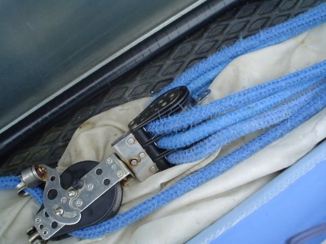

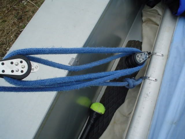

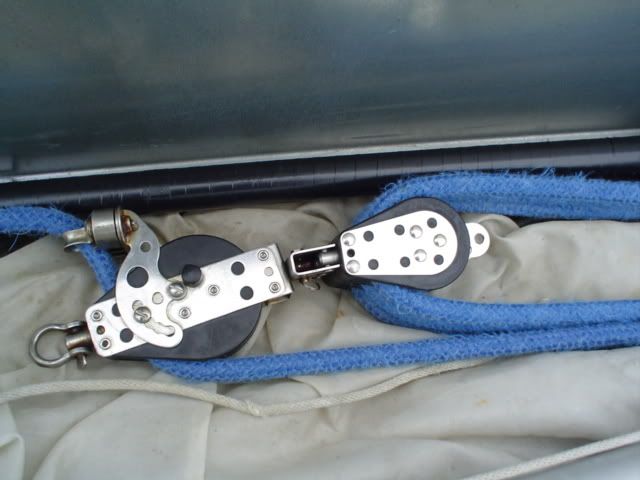

Secondly, the mainsheet system seems to be unique compared to anything ive seen posted on the forums before. The boat has a triple block hanging off the boom, with a triple block attached to a ratcheting single block with cleat connected to the traveller. The problem is that when the rig is set up, the cleat faces off the stern of the boat, making sheeting very difficult. Also interesting is that the sheet is tied off to a hanger on the boom, producing an interesting arrangement. I managed to draw a horrible picture on MSPaint showing the setup, but i cant seem to post it. Any help on how to properly rig this system so that the blocks make sense would be much appreciated. Also, if someone can tell me how to post the picture, I think it would probably help to illustrate the situation.

ok, i took some pictures of the mainsheet system, let me know what you all think
thanks for all the advice with raising the main; ill definatley try some of it out next time i get out on the water.
http://i156.photobucket.com/albums/t32/ ... C01105.jpg
http://i156.photobucket.com/albums/t32/ ... C01104.jpg
http://i156.photobucket.com/albums/t32/ ... C01103.jpg
http://i156.photobucket.com/albums/t32/ ... C01102.jpg[/img]
PostPosted: Fri Apr 13, 2007 2:47 pm
Posts: 366
Location: Abq, NM
That does not look too bad, I would try and swap the block on the hanger with the tied off end. That should allow the bottom block setup to spin 180 and face forward.
Sam
PostPosted: Fri Apr 13, 2007 4:27 pm
Authorized Hobie Dealer
Posts: 1369
totally if that bottom triple could be swapped with the upper it would work better, I've been killing myself trying to figure out how this could work better. There is a Becket in the middle of the bottom block, you would use this as a tie off point instead of the extra block hanger.
