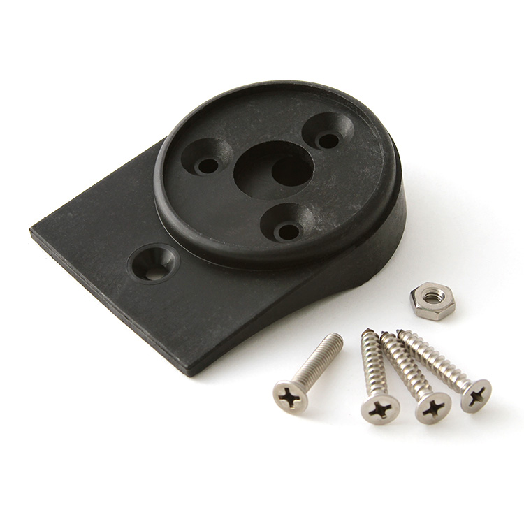

2. I have bought 3 x swivel clam cleats for the main and jib but they have flat bases. Can I reuse the old ones and will self tappers do to secure them?

You should be able to re-use the mounting plates. If corrosion is an issue, you can move a bit to one side.
This is the mounting plate Image
