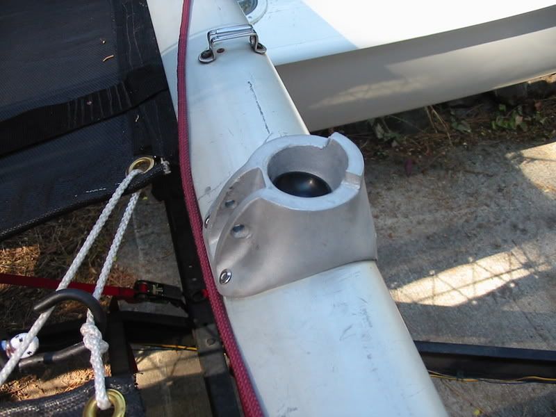

Hello All,
I recently obtained a used mast step in much better shape that the one on my H16 right now. (The step limits were really chewed-up). This replacement is practically un-marred. Question, I soaked the rod threads with "liquid wrench" overnight before I removed the rod. After doing so I observed that about 1/3 of the threads in the aluminum were stripped away with the SS rod. Can the remaining threads be chased clean? If so, what is the pitch so I can buy the right tap/thread chaser? Is this rod in compression or in tension while in use? I think I might have made a mistake by removing the rod (wanting to keep my dophin striker/rod assembly intact and just spin on the better mast step casting).
Comments please!
Regards,
Eric

The dolphin striker post (vertical member) is in compression. I don't know the thread dia/pitch (it's probably a standard (non-metric) coarse thread at what ever diameter the post is). I would thread the post into the step. If it's tight, you're probably ok.

Here's what worked:
9/16" 18 NF tap was used to clean-up the casting threads. The striker post threaded in just fine.
I'll remove the old one pretty soon.

PostPosted: Wed Sep 26, 2007 11:46 am
Joined: Sun Sep 04, 2005 9:47 pm
Posts: 133
Location: Spokane, WA
Finally installed the replacement:
Lessons learned:
-Just like the "how to" article mentioned, the existing rivet holes are not always reuseable. Mine happened to line-up almost exactly.
-I used the scissor jack from our small car to great success.
-Use a small wood block between the dolphin striker rod and your mallet, lest you mash the striker in tight while raising the old mast step away from the crossbar.
-Use anti-seize compound on the thread so the next time (hopefully not), the aluminium threads don't shear away while unscrewing the mast step.
-I did have to trim/file the rear edge of the mast step to have it sit flush against the crossbar.
Eric
H16
Sail# 11500
