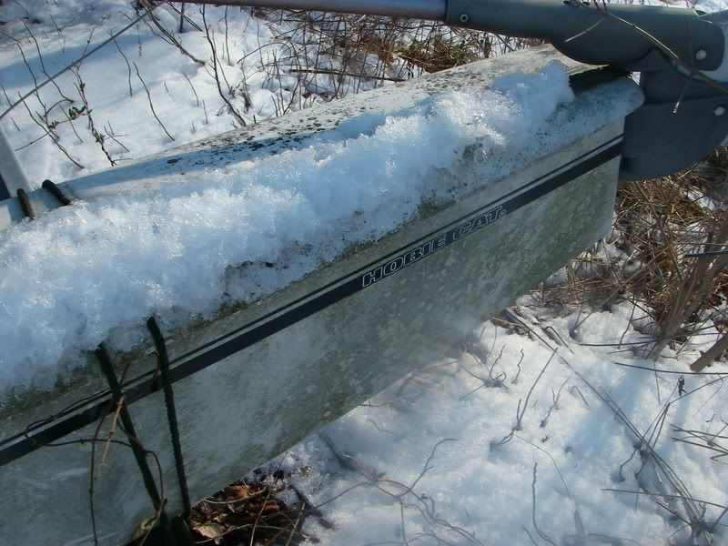

So I went today to check out a 16 today. The boat is an 84, I believe as determined by hull no. There are some inconsistancies though, i think, between the number and how the post on this sight says to interpret them. The number ends with M84K, for example. Isn't the m's slot supposed to be the month? M would be the 13th month though. And isn't the K supposed to relate to the build year vs. model year? Shouldn't it be a number then?
Anyway, the boat hulls seem stiff. They are incredibly dirty but it seems like much of the shine could be brought back out of the gelcoat, perhaps thanks to the uv inhibiting layer of dirt. I checked the tramp upright/hull unions and they seem watertight and stiff. All the running rigging though looks like it will need to be replaced as it is all black, moldy, and looks compromised by rot. The railrug is all but shot too. The rudders are plastic, but seem to be in okay condition. There is a trailer, the body of which seems good, but I think the wheels, tires, bearings will all need to be rebuilt/replaced. How much will it cost me to replace all the lines, assuming I don't order them all straight from Hobie and get them somewhere for less? What if they're all from hobie?
Secondly, when i decide to start upgrading, how much will epo's, windicators/vanes, hotstick, cat trax, 6:1 downhaul run me? I know they're expensive bits, but does anyone know the specifics?
Knowing all this and seeing the pictures I plan to attach (hopefully I get it on the first try) what should I offer the guy for the boat? Keep in mind it hasn't moved for 5 years, so he may not be looking for much more than to get rid of it--who knows. How much is it going to cost me to get this boat in racing condition?
Thanks in advance for all your help everyone!
-Seth

Unless you did it after the photos were taken, you didn't check the most important aspect - are the decks soft in front of the trampoline?
RE: The hull number - M84K means it was made in the 10th month (K) of production in 1984.
84's were good (lightweight) boats - but you'll need to spend a lot of $ to get this in racing trim:
Comptip - about $300 (might be able to find one on eBay for considerably less)
Lines - about $200, depends more on what you get rather than where.
Standing Rigging - 24 years is a lot of time even for stainless - about $200
Sails - 24 year old sails will be OK for day sailing, but to race, you'll want new. About $1,500
Rudders - probably most important - $500 for new EPO's.
Cat Trax - $500
Other misc bits - $200 - $500, depending on what you need (does it have a low profile mainsheet system?)
Order a Hobie Catalog and you'll have the prices for all this stuff.
If the decks are soft, walk away.
If the decks are OK, then I'd offer the guy $500, and be willing to pay up to $1000. There's a lot of work to be done.
Trailer work (Tires, bearings, lights?) will be about $150.
If you're serious about racing, you should try to find a 1995 or newer boat.
BTW, I'm UofM NAME '82. I owned an '84 that I bought new.

Thanks Guys,
The boat does have a comptip, surprisingly. I've been spec'ing out prices on lines and such at murray's and it seems like it'll run me 400 - 600 if I need a new main and halyards.
I checked the hull pretty much everywhere but the top of the deck in front of the tramp. I'll do that this morning--the boat's on my running route.
I ordered the catalog yesterday--just wasn't sure if they would include the prices, as the online catalog did not.
Seems like to replace the bearings, lights, wheels, tires will be more than 150 actually...
Are you saying be willing to pay up to 1000 for the boat alone? Or for the improvements. I think you mean the boat alone, but just making sure...
Anyone know of a boat in better shape?

PostPosted: Tue Feb 26, 2008 8:16 am
If the decks are solid, I'd be willing to pay up to $1000 for the boat and trailer as it sits - primarily because it's an '84 (light) has a Comptip and has rake-adjustable rudder castings. Offer $500 and go from there.
But like I said, if the decks are soft, run away. It's not worth it.
For lines - Check out www.hallspars.com. They are having their "Spool End" sale. You can pick up high tech lines at rediculous prices.
I all liklihood, the bearings don't need replacing - just cleaning and repacking.
The Hobie Fleet in Syracuse are a competitive bunch and they turn boats over fairly often. You might be able to find one just a few years old for about $3,500 (which is what you'll end up spending anyway). Check their forum at http://www.fleet204.com/204um/204forum.asp.

I just checked the boat and the decks seem very solid. They seem thicker around the tramp uprights than the rest of the deck--this is the case, right? It's not that the rest of the deck is deteriorating?
I'll check out those boats--the only difference is that I'll be able to do this boat incrementaly, as far as pure upgrades go, once I get it fit to sail at all. Though, those boats are probably newer, which is obviously and advantage. This hull seems in good shape though ignoring the dirt.
