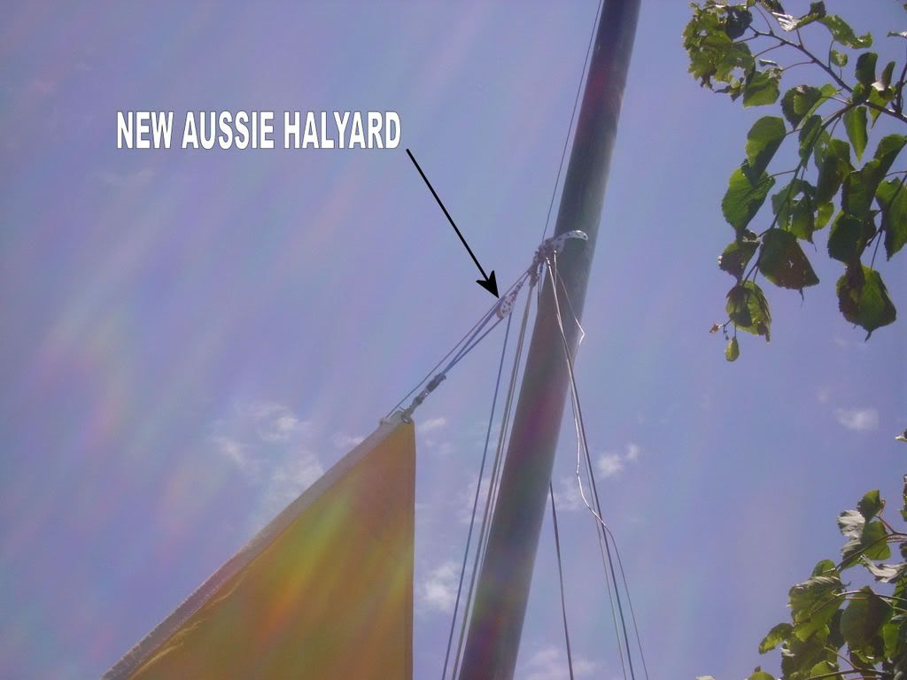

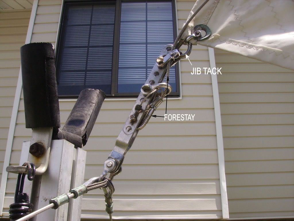

You can see from the mast bast that I have clearanced the base to miss the hinge. The Jib tack picture shows the weird way I had to rig it to prevent the mast from falling over. I think that if I was not gentle with it, it would jump out of the base. The mast top picture is just to show the rigging at the mast top. I think that I am just going to shorten the forestay. Thanks for any comments and suggestions.

 Post subject: Problem with solutions.
PostPosted: Wed Jun 18, 2008 2:00 pm
Joined: Fri Aug 18, 2006 1:11 pm
Posts: 313
Location: West Point, Utah
The problem with putting the forestay in the lowest hole at the bridle is illustrated in the Jib Tack picture. You have to put the jib on over the top of the forestay because it is in the way and can't be moved as it is holding up the mast. I'm shortening it about 8 inches. I just have to figure out who has the swages and tools to do it for me. Thanks.
