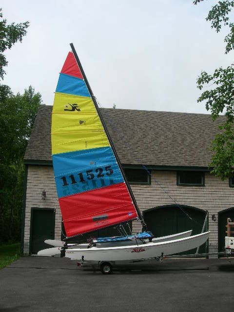

I am trying to set up my brand new H16, so far unsuccessfully. There is too much mast rake. I have the front forestay in the 2nd hole from the top on the adjuster and the shrouds are in the 2nd hole from the bottom. When I add jib tension, it does take up the slack in the shrouds, though it only moves the mast forward slightly. Wiithout any downhaul, the boom takes a position just 10 inches above the traveler without enough room for the main blocks.
It seems like the front crossbar is bowed up and back too much, and seems higher compared to the aft crossbar than pictures I have seen, but maybe that's my imagination.
Please, you thoughts?

It looks like your main is not raised to the top of the mast.When you get the main to the top it will raise the boom.

Ditto on the no jib rigging, bad idea on the Hobie 16. Hey, I went from zero to Hobie 16, if I can do it, you can do it.
One thing I noticed in the picture is the Main sail is not hoisted all the way to the top. Have someone help by pushing up on the batten pockets while you tug, push up slack and tug again until she's all the way up, and then while holding tension on the halyard, lock it in the vee cleat (way up near the top) by holding the halyard against the front of the mast. Pull down on the boom, sail should move a little, but not fall down. Repeat if necessary until the halyard's locked.

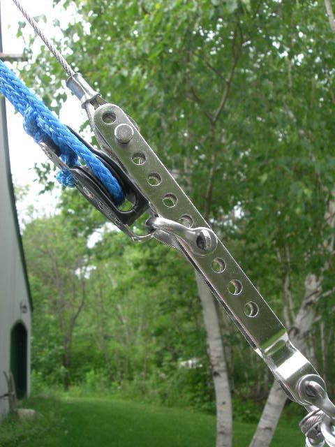

Hey, I don't own a 16 and never rigged one, but looking at the pic of the adjuster, you are connecting the forestay in the last hole at top, which if I did on my Wave (I have the same adjuster), my mast would be way raked. Try bringing the forestay down 3 to 4 holes.

the forestay is rigged correctly.
f you rig your wave like this you will go up wind better!

Others have already commented but I'll throw in 2c. The mainsail is clearly not up all the way. The halyard has to be hooked in the "catch" at the top of the mast. The position of the forestay in the adjuster makes virtually no difference since the luff wire in the jib is what ultimately supports the mast while sailing (the forestay should be slack). Rig the boat with the main fully hoisted and the jib installed. If the rake still seems too extreme, you can move the shrouds up in your side adjusters (you said you were in the 2nd hole from the bottom, so there's room to go up). I'm not a 16 guy, so I don't know where the top racers run the mast, but at one point I believe the ball park measurement was to take the main halyard to the front bridle bolt, mark that spot, and it should be about 1 foot below the hull at the bottom corner of the transom (with the boat fully rigged).
Oh, and the front cross bar is supposed to have more arch than the rear (which I believe has none).

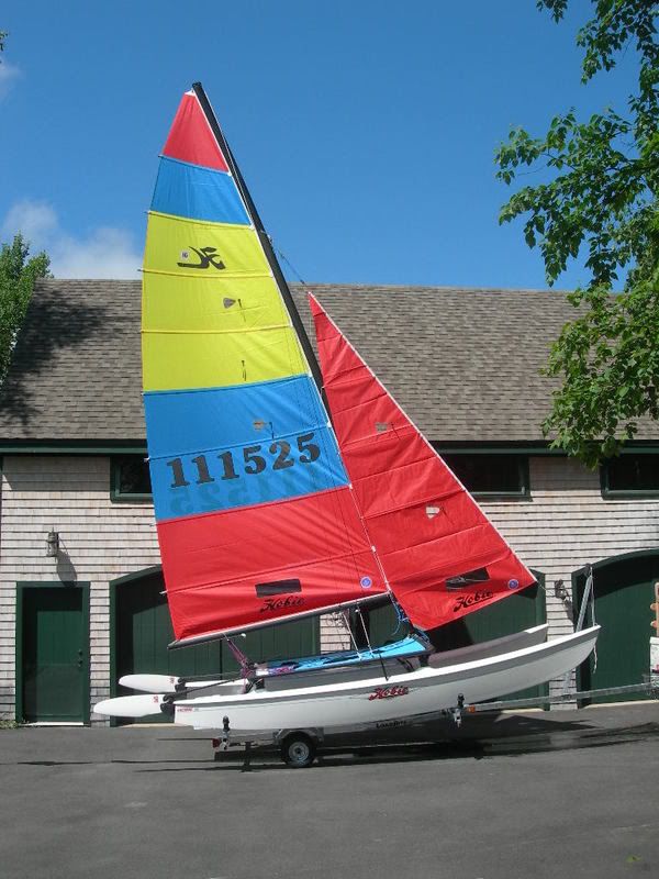

I'm getting closer. It was hard getting up the last 10 inches to hook the main halyard. I also went up to the middle hole on the shrouds.

Pull the jib tighter, it looks like it still has slack in it, the jib should be holding 100% of the weight with the forestay just flopping around.
