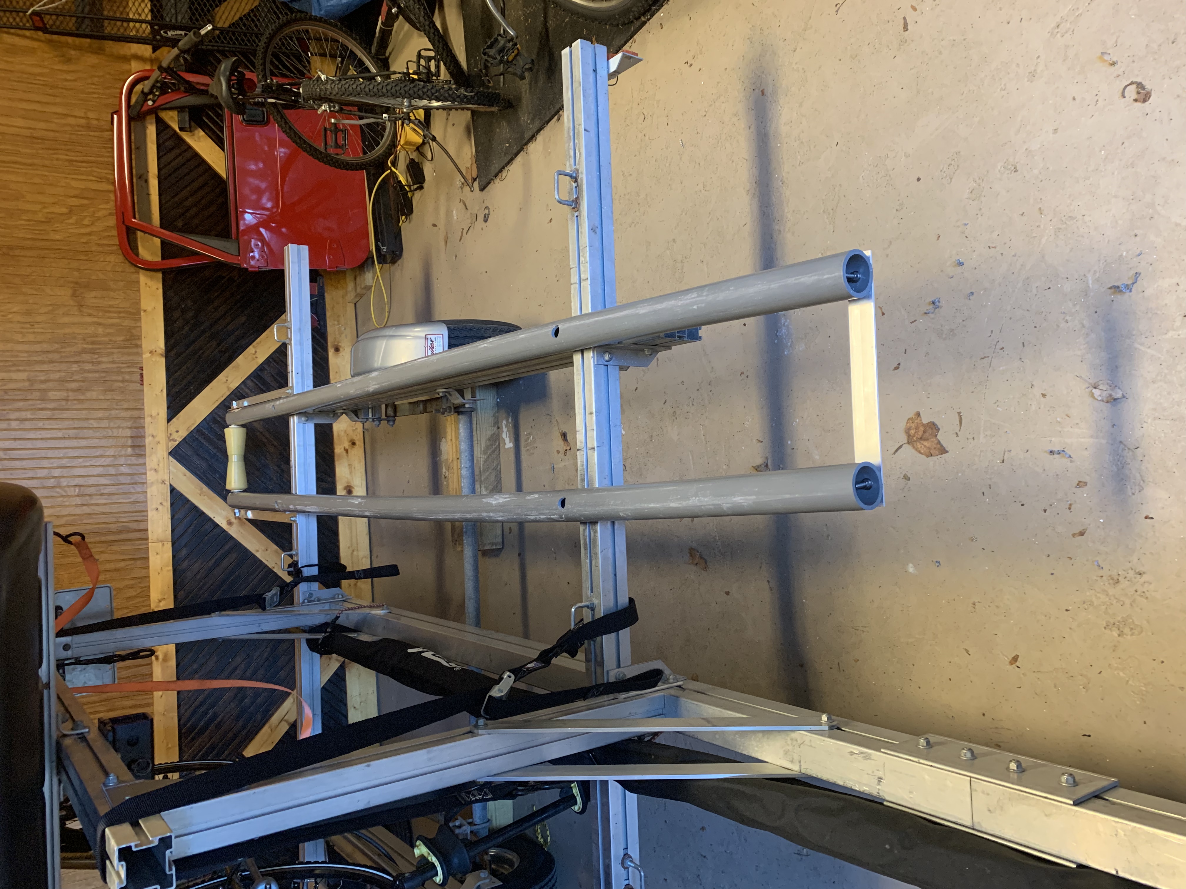

The photos below show my bow roller at the back for loading and unloading, and another brace at the front for shaping. The PVC flex is intended to provide more contact area between the pipe and kayak to distribute the load so the hull doesn’t distort. Do search the forums as there are many ideas, discussions, photos, and explanations on trailer setup with pvc bunks.
