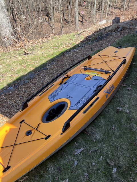

Waiting for actual H rails, I made this from 1” square aluminum t track and 1” thick HDPE sheet stock. Since the photos I lowered the end pieces to reduce the rail height- the bottom of the rail is now 1” above the deck. I also added 3/8” HDPE pads under the end pieces to broaden the contact area with the deck.

Another view, showing the bend matching the hull curve.

those rails look pretty clean dave

Thanks fishtacos18! I see that Jackson Kayaks are now using essentially the same rail, calling it Tri Track.
