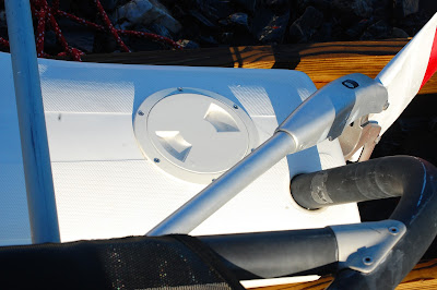

I just did all 4 and it was simple, nothing there (18" behind front x-beam and 18" behind the rear x-beam as Matt says). It did take a while to get all the small cracks sealed. The tubes are not super clean (rough) so hard to get the glass to form a nice covering. I ended up using some filler as well. It didn't look pretty on the inside. Curved deck plates help but are not perfect. They need more "curve". For your fix, you might insert PVC tubes (waxed with mold release) and have them in place so you have something to form around. Good luck.

Visual for you.
