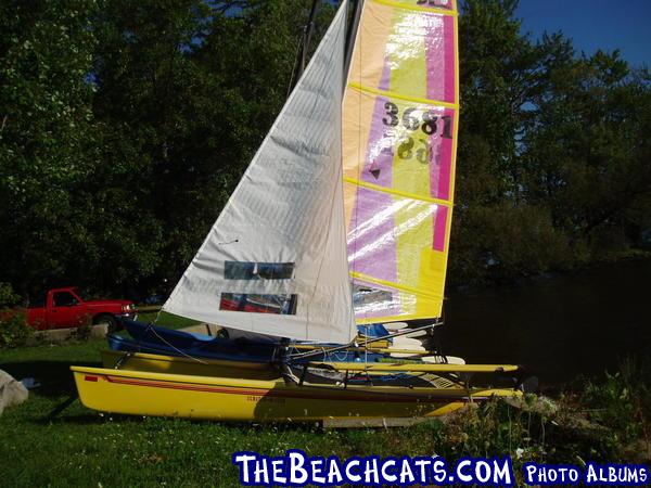

Ill start by saying thanks in advance to this forum and its members!! At 34 I caught the sailing bug on my annual Caribbean trip with a fun little Hobie wave about a year ago(so pardon my terms, i am still learning, but defn a lifetime sailor from here on out and wish I woulda done this YEARS ago!). As soon as I got back I purchased a 1987 Hobie 16 and went through the motions of bringing everything up to date. Chip at Whirlwind Sails did an excellent job on my new main/jib and keeping me in the loop through the process. I sailed through the winter on my local lake (only 2 miles from my business so it makes life easy!) and learned quickly how to right a cat in the cold water but I am continually learning how to sail.
the 16
Ok now onto the good stuff. Found a 1995 Hobie 17 (SE i think, that has been converted to a Sport? Maybe someone can look and tell me) and the gentleman gave me a GREAT deal, i learned on here what to look for...and minus a few dings on the front crossbar from improper mast hoisting, it is amazing shape. Wing mounting holes dont leak into the hull, no cracks crossbar, the bottom of the hulls have NO damage (i had to reglass the bottom of my 16 and that was no fun...thus the black hulls), dagerboards are nice and springy (he stored them in the down position!) and boat was stored undercover with comptip out of the sun and rudders removed. Reason for 2 boats? Because as much fun as the 16 is, in a the higher winds with the Whirlwind sail it is constantly flying hulls and i was always trapping and also I wanted something i could sail solo and the wings are amazing cause I get a bit lazy (maybe my tax return was better than i thought :P .)
First impressions from the last weekend (winds where 10-15 mph, with gusts 25), AMAZING!!!!!!! LOVE IT!!! Once i left the little cove that was protected from the wind, she took off downwind (something i wasnt used to in the 16). I was chasing down and walking past another 16 on the lake. :o I thought for sure without the jib it was gonna be slower. It also seem a little easier to sail, maybe b/c i didnt have to trap and the wings make nice seats/backrests?!?!? Playing with the mast rotation, downhaul and outhaul was a new learning experience too. On to the questions:
First pic of 17 (i didnt hook up the jib cause I wanted to shake down first and i defn didnt wanna be righting all day due to my inexperience).
I am assuming this is the 7:1 block setup? overkill? Seemed to work great.
A:I am assuming this is the jib 'tension' line? Once you release the roller furler this will bring the back of the jib in as needed? Again sorry if those arent the correct terms! Also, I am used to the H16 jib system which is why I am confused with this.
B: How to these tracks work with the above?
C: Is the righting line run properly? it is run through the dolphin striker on the front crossbar.
I am fairly certain this is supposed to have 2 small blocks and attach to the rear of the jib like the H16 setup? If not...HELP! :D
Mast rotator bungee? The bungee is shot, but I can replace. Please explain how this works and if it needed?
Another pic of downhaul/mast rotator. Dont mind the pinkish/red line around the rotator, i figured that out 8)
PLEASE let me know if you see something that isnt correct and thank you for your help in advance!

I'm a brand new H17 owner myself, so glad to see someone else who's going through the same learning curve!
Yes, you have a Hobie 17SE that was converted to Sport. The boom is the giveaway. My 1990 boat is the same, but the boom was later replaced by the Sport "boomlet" (a highly desirable upgrade if you are going to sail with crew).
Yours is a custom Hobie Sport conversion, however. The standard "Sport" doesn't have a jib track - the jib blocks just attach to the front crossbar. Your jib track looks like it's designed to fit the larger Hobie 18 jib... I believe this is also known as the Hobie 17 "super jib" setup. (You'll find more info if you Google that term).
Here's an example of your "super jib" setup:
http://www.thebeachcats.com/pictures/?g2_itemId=59458
Your "jib spreader" (the metal bar that attaches to the 2 bows and to the jib furler) is also custom. The standard "Sport" has a different (somewhat flimsier looking) metal bar. That's the other giveaway.

This is a great resource on H17, including some information on mast rotation bungies
http://www.hcana.hobieclass.com/default.asp?Page=9302&MenuID=CLASSES___%7C%2Fc20071%2F9268%2F
Make sure to check out H17 tunning guide, part 1/2
http://www.hcana.hobieclass.com/site/hobie/hcana/downloads/class%20info/Hobie17/Sweet%2017%20Part%201.pdf
Awesome sail on your H17, BTW. 8) Do you know who made it?
Oh yeah, welcome to the forum. :)

Welcome to H17 sailing. I sailed a H16 (mostly solo) for 20 years before getting a 2000 H17Sport in 2002. The H17 loves high wind and does very well in a breeze. I too use a 7:1 mainsheet system with a 49 ft 3/8 sheet, and in a blow is definately not overkill. Other modifications include, 8:1 downhaul (this is overkill, 6:1 would be sufficiant), integrated tracks for jib and main (I replaced both cross beams, more about that later), WhirlWind SuperR Square top sail and jib, 5" ports with BottlePorts http://www.youtube.com/watch?v=ctJODgd4YLw&feature=player_embedded(nice feature for drinking while sailing) and 5/32" shrouds (1/8" is standard) replaced every 5 years.
Now the bad news - Cross beams - Since 2002 I've replaced the front cross beam 3 times (the last -under warrenty- after only one season) and the rear once due to cracks.
http://www.thebeachcats.com/pictures/?g2_itemId=100804
I check the tightness of the beam bolts and tighten the tramp regulary. Note: I do sail hard, usually in moderately high winds (8 - 25 knots) and waves 1 - 5 ft, 40+ days a season so this may be a unique issue. On the plus side, both the front and rear corssbeams now come with integrated tracks. This cleans up the rear crossbar (no external track) and allows for a track system to be used for the jib (see pict of my mod)
http://www.thebeachcats.com/pictures/?g2_itemId=61752 :wink:

Your jib looks like the Murrays Marine upgrade kit I had on my H17. I never used it so I sold it. Not class legal for racing. I thought I would eventually convert the H17 to a kite rig and use the parts for that but never did. My spreader was a lenght of boom extrusion which is different than what is in your photo. If you need the manual for the Murrays Marine Jib kit, the parts guys at Murrays were able to email the instructions as an attachment.
It looks like you are not using the downhaul system, the two cam blocks on either side of the base of the mast, that someone installed. Its a very necessary system to power and de power the H17. There may be instructions online on how to thread the line through the downhaul. Someone on the forums may have a guide. I can photo mine if you need.

Thank you for all the advice! Time on the water has defn been the best teacher with the boat. Luckily im only 2 miles away from the boat ramp and i've gotten to the point i can have it in the water with sails up leaving shore in just under 30 min. Ive also started using the jib and it really helps in the lighter wind conditions, though im still confused on how the jib traveler tracks on the side affect the wind flow on the leeward side of the sail.
The tracks along the sides (similiar to the H18) vs along the front cross beam (standard H17Sport Jib) is due to the larger size of the 'Super Jib' relative to the standard H17Sport Jib. The track allows you to control the slot between the jib and main sail. If the slot is optomized the wind will be pulled faster between the two sails and you will go faster. If the slot is too wide or narrow, slower. As you travel out the main also travel back the jib and visa versa. 8)
