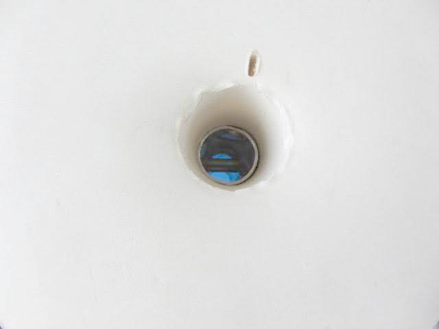

Looking through the tube, you can see the rods that provide the rigidity and resistance to internal rotation.
