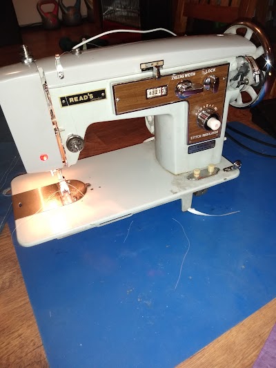

Reads Sailmaker Sewing Machine:
Shortening the H16 tramp to match H14, added supporting vinyl and webbing between layers for extra strength, eyelets to be punched.
Homemade punch turned on lathe and new spur grommet inserted:
I said it wasn't pretty, had major issues with sewing machine and the fact of having only two hands ;-)
