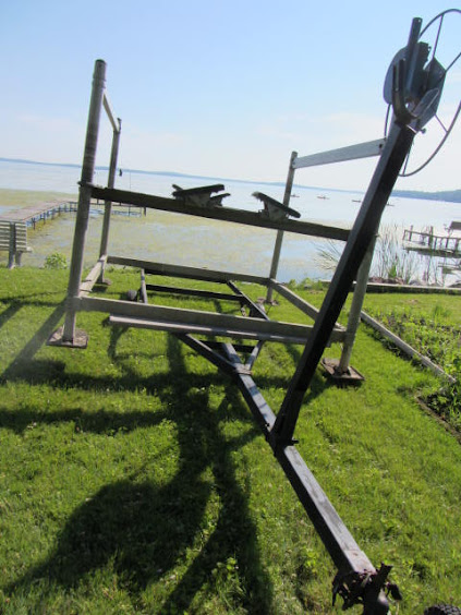

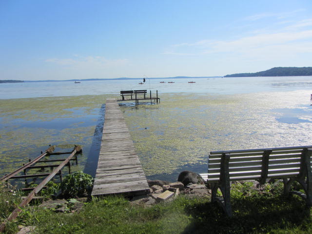

What was left of the stripped down H14 trailer was used to move a Shore Station lift for the dinghy. Awaiting install at pier (right side)...
Rail system to left (for H14). Shore Station to go at pier end to right (for the dinghy). Green is the color of this lake around the 4th of July...oh well...

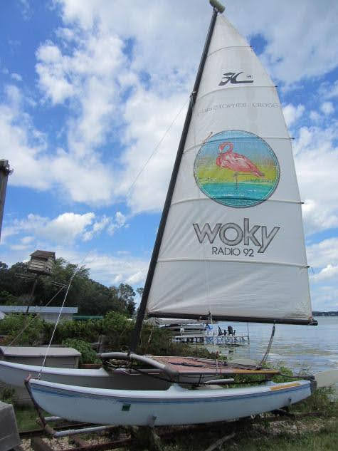

And now it's time for a REVEAL...
I guess this isn't your ordinary Hobie 14, but some kind of promotional deal with what is likely a unique sail...
That's Christopher Cross's album cover/logo art from the early 80s, and a reference to AM 920 WOKY in Milwaukee, also from the early 80s. I didn't follow Christopher Cross, but I see he did sailing related songs (like "Sailing" and "Ride Like The Wind"). Also an active sailor in Austin, TX, though lately suffering from COVID-19. He may even be on this board...
Anyone with interesting background on the boat...or at least the sail?
