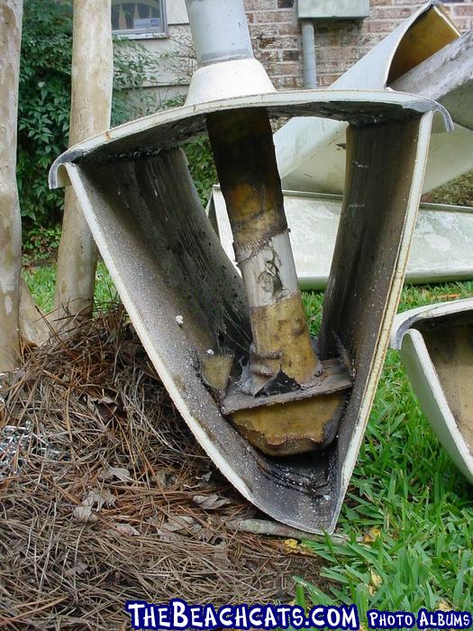

One more question. Its been said 'sailing with the top deck of the hull delaminated can cause major failure'. My question is how it the riser connected to the hull? Is it fiberglassed securely to the bottom of the hulls or is it more secured on the top?
PostPosted: Fri Jul 30, 2010 10:10 am
Posts: 318
I believe it goes through the top and attaches to the bottom in like a boot thing. Before you do all this work repairing your old hulls you might want to look into finding a new set. I bought a H16 with no tramp and missing other parts but with awesome hulls for $200. After selling the stuff I didnt need and keep stuff I wanted doubles of, I ended up with a profit and nice solid hulls that should last me as long as I keep the boat!
