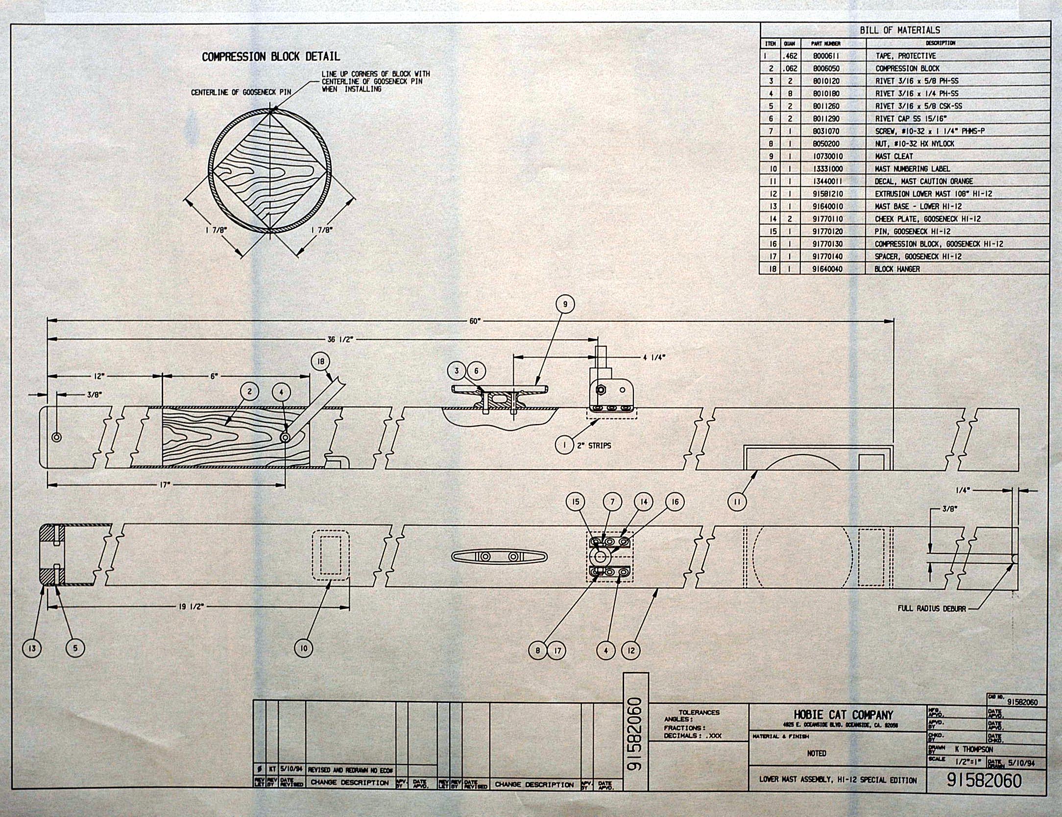

Actually. now I have read the diagram and looked at what I actually have. It seems I have the upper section, but am missing the lower section.
Is there a spec for the lower mast section?
Any details would help.
Thx Ian

Actually, is the upper section the same as the upper section, but without the Cap in the end?
Can I just remove the end cap, move the upper section to the lower and insert a cut-off windsurfer mast as the upper section?
Thx Ian
PostPosted: Fri Jul 17, 2020 11:50 am
The lower was aluminum. Maybe best to use a whole windsurf mast.
PostPosted: Fri Jul 17, 2020 12:10 pm
Joined: Fri Jul 17, 2020 10:04 am
Posts: 5
That's great thanks.
I will make it work.
