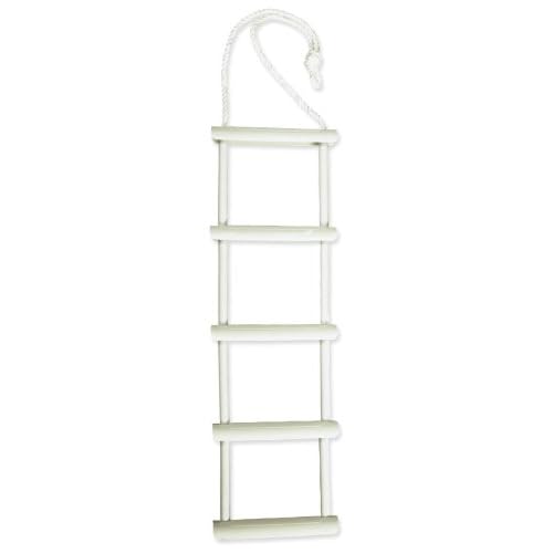

I cannot get back on myself, too much freeboard. I have a marine rope ladder with plastic rungs that collapses to a small bundle, it hangs from the forward, starboard wing base. When bundled with bungies it is hardly noticeable.

Great picture. Can you explain how the ladder is attached? Do you have two side ropes for the ladder, both attached to the front wing arm?

Stearns 5 step folding ladder
http://www.amazon.com/dp/B000FPXXZ4?smi ... nkCode=asn
It is simply passed through itself as an attachment. The pipe sections fall into place when deployed and steady the rungs.
