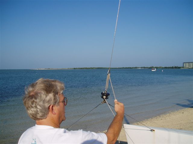

The solution to solo-stepping is simple. We do it on the Dunedin Causeway in FL for any boat up to 6 meters. We call it a "Portuguese turnbuckle". Read my post on Catsailors from back in 2009.
http://www.catsailor.com/forums/ubbthreads.php?ubb=showflat&Number=184433
How to secure your mast once upright.
First, get rid of the forestay chainplate. It's an awkward device and you can drop a pin. Instead, tie about 3 feet of 5/32 line to the shackle at your bridle junction. When your mast is horizontal and pinned to the front beam take this new line and take a loose turn around the horn cleat to hold the line on the front of the mast. Climb up on the tramp and lift your mast to vertical. It is NOT heavy. My son could do it at age 11. As cat masts go, the Wave mast is one of the smallest and lightest.
Once you have the mast vertical, lean into it to hold it vertical leaving both hands free. Looking up, you'll find the forestay hanging by your head. Lead it forward of the mast and hold it with your right hand. With your left hand reach down and get the bridle rope from the horn cleat. Thread the bridle rope up through the thimble of the forestay, back down and through the bridle shackle again, back up to the forestay and through the thimble again. Pull DOWN hard to tension the rig, now using a 4-1 advantage. Once tight, take one more loop, shackle to thimble, for 6:1 and tie it off to itself with a rolling hitch. It's very strong and allows any mast rake you'd like.

Here is a photo of mine for a Mystere 5.0XL fiberglass catamaran. I've used this system for 18 years on a dozen boats. The Wave is super easy since you can reach the turnbuckle from the tramp while holding the mast.

Thanks dparker for the detailed instructions and photos. I think even if I stick with a pin, a short line tied to the bridle and then to the cleat will make things a lot easier. Since I am still new can you explain a little further what a 5/32 line is and where I might find some. Is that just the diameter? I think I'd like to try both ways and decide from there.
