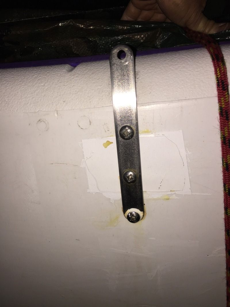

I also have a wave Hull question. I am looking at a used wave now that has some cracks where the stats attach to the hull and at the drain plugs. All areas have been coated with sealant that appears to be holding.
My question is how worried should I be about the cracking at the side stay? If I can get the boat at a good enough price I would be okay with repairing it on occasion but do not want to buy it if it is not going to be safe to sail. Any input would be much appreciated.

I found out the crack is not at the shroud mounting but at the bridle mounting up front. Does this make a difference?
How did you access inside of hull to put the fender washer on?
Also I read the G-Flex can be tough in install. Did you have to sand some of the cross linked surface off to access the foam core?

the bridal up front may be harder to repair. Take a look at this "boom bail" http://www.westmarine.com/buy/ronstan-- ... cordNum=38 from west marine, I think this could be bolted through and take place of the bridal eye strap.
I only used the gflex from the outside as I could not reach all the way up to the front cross bar to apply it there.
There are access ports under the blue seat pads.

thanks for input! much appreciated. Agreed the cracks at or near the plugs would be least concern as those can simply be siliconed.
I have an image sent by the owner of the front bridal attachment...
not sure how to upload...
