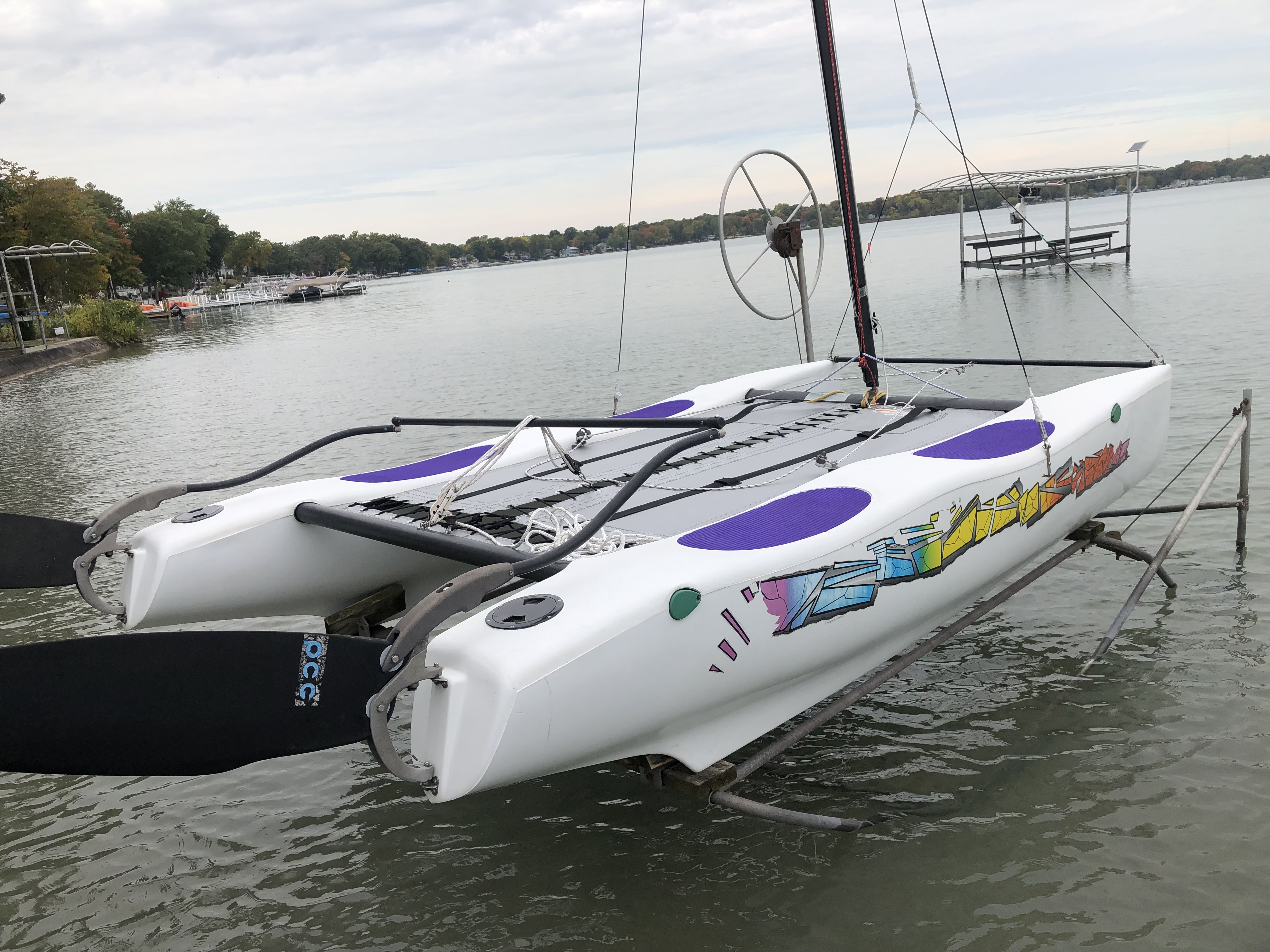

I don't see why a jet ski type floating dock wouldn't work. If your water depth is shallow you can use a boat lift. I have mine on a old cantilever style with 2x6's that go across the beams. I see these types of lifts for sale all the time for next to nothing. I do secure the lift to the bottom of the lake and also have the front beam of the boat tied to the lift so it doesn't blow over in a storm.

That looks dope! But what is going on with the other lift in the background completely away from land or dock? Is it flooding in that picture?
Also, do you put your mast down to protect it from high winds?

I leave the mast up all summer, no issues. That other lift is all alone just because the dock is not in that goes next to it.
