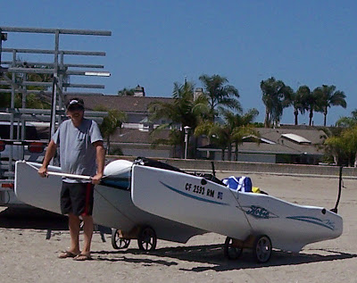

I built my own beach wheels with wood, stainless steel bolts as axles, carpet padding and lawnmower wheels. If you go this route, get the widest wheels that you can to distribute the load across the sand. Mine dig in in soft sand, but I'm a manly man and can handle it :wink:
Here's a cool trick: Get yourself a couple of S hooks, some rope and a small diameter (say 1") PVC pipe about (3) or (4) feet long.
Run the rope through the inside of the PVC pipe, tie the rope on both ends to the S hooks, crimp the S hooks down so the rope won't slip off. The contraption should be sized to span the (2) forward mounts that you clip the forestays to. VOILA! A nice, comfortable towing bar that clips on and off super easy breezy for when you're rolling your WAVE up and down the beach.
One of my friends saw me pulling my WAVE down to the water this way and called me IRON MAN. Little does he need to know that it's darn near effortless if the wheels are placed so the boat is balanced.
Yep, and I lift my WAVE in and out of these homemade wheels every weekend, no problem.

Corey, I like the idea of the pull handle! Now I know what to do with the leftover piece of PVC from my tiller extension project.
But we need photos of your beach wheels. You left a little too much to the imagination. Did you just make two little "cars", one for each side? Like the Cat Trax cradles, without the Cat Trax, each with their own little wheels?

<a href="http://picasaweb.google.com/corey.comstock/Hobie_wave/photo#5215649607081831698"><img src="http://lh5.ggpht.com/corey.comstock/SGG1rxcErRI/AAAAAAAAADw/BuVhfwMjuUU/s400/dolly.jpg" /></a>
Here's the day my friend called me Iron Man (I obviously like that :D )
You can see the tow bar that I mentioned.

Here is a pic of top and bottom of the beach wheels. Notice the eye hooks to hitch a rope (with S hooks) around hull to keep the hull from sliding off the wheel)
