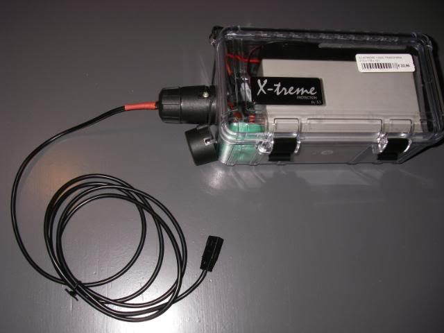

Hiya!, my solution sees plenty of salt too!
12V 7 aH, battery in a sealed box, the 12V charger cable also became a connector, so it can be connected directly to the battery or used with the orginal clamps for other purposes
Using it to power a B&W 565 HB FF, it lasts for days
PF
