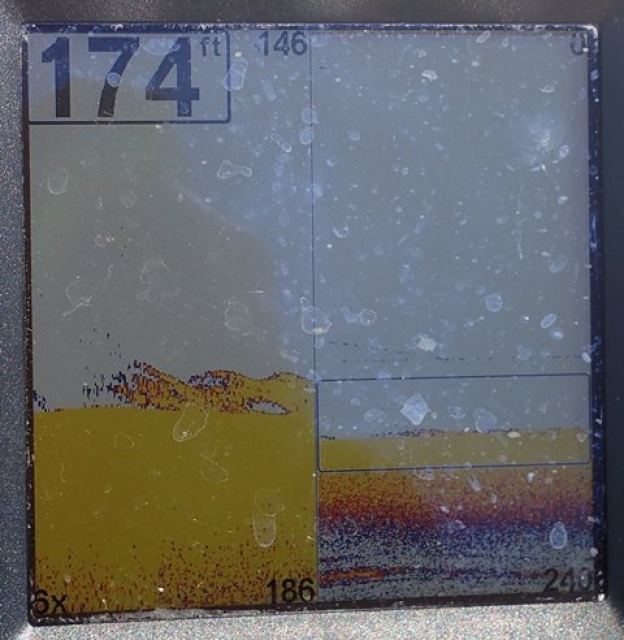

There are two reasons to mount your fish finder near your knee on the gunwale of your Revolution, rather than in the mast mount at the front of your kayak's cockpit: (1) If you mount the fish finder near your knee, you'll be able to easily see its screen, but if you mount it in the mast mount, it'll be harder to see the screen, and (2) If you mount the fish finder near your knee, you'll be able to operate its controls easily, but if you mount it in the mast mount, you'll need to slide forward in your seat and reach way forward in front of your feet to operate its controls, and thus may not end up using the fish finder's capabilities as effectively.
For example, I do a lot of jigging for lake trout which are right on the bottom in 170-240 feet (52-73 meters) of water. I use the following fish finder screens when doing the jigging:
(a) A split sonar screen, which shows the entire water column on the right side, and only the bottom sixth or eighth of the water column on the left side. I can barely see lake trout on the bottom on the right side of the screen, but when the return is magnified 6x or 8x on the left side of the screen, when the bottom is fairly flat I can see lake trout clearly.
(b) A GPS screen with Navionics lake maps, zoomed in very close. I use this screen to pedal slowly up-wind and up-current to hover over lake trout which I have located with the sonar screen.
I often switch between these screens every couple of seconds. If my fish finder was mounted at the front of my cockpit, I couldn't do that.
