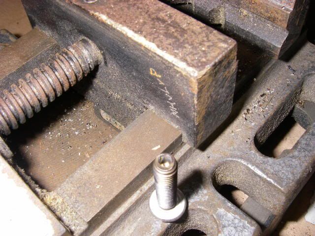

Back to the workbench...
drilled a 3mm hole in the bolt and superglued electric car wire in it.
Did the same with the bolt and washer, glued it to the spanner. (there is another bolt in it to keep the stuff aligned while drying
Using the electric cord as a guide we (the Missus held the screwdriver, my boy held tension on the cord )while I fumbled with an gripper spanner combination up till my ear through the round hatch in front of the seat, But it worked!!
After hearing the nut contacting the spanner, the missus worked the screwdriver and I felt the tension on the spanner!, after so many rotations the electric cord snapped as planned, and after some persuasion the superglue holding the nut & washer gave way too.
