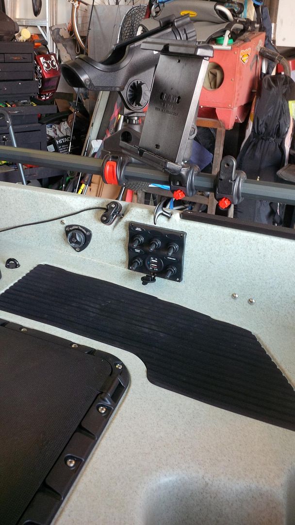

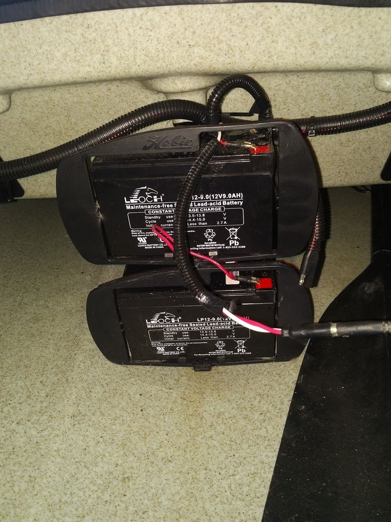

DavidJ1963 wrote:
Mtmouse wrote:
Can you use a 12volt 12ah battery and get more use per trip or how do you know how many ah to get? I want one to power my fish finder and eventually run some led light strips inside and out side my Yak and maybe charge my cell phone. But I want it to be able to last a long day with some power to spare. I don't want to run out! Lol! Thanks!
I actually run two 9ah batteries wired in parallel, which theoretically gives me 18ah and use a marine switch panel to control everything.
PostPosted: Sat Mar 19, 2016 12:44 pm
Posts: 237
nice setup!!

Wesrams wrote:
What guage of wire should I use to essentially accomplish the same thing you have here?
Mtmouse wrote:
DavidJ1963 wrote:
That is a very nice and clean set up! Where did you get the marine switch and how much was it?
What does the battery holder and batteries cost each? The one thing i dont like about the battery holder is that water can get to the batteries and I have heard if they get wet it can cause a fire or some kind of problem. Not real sure what the problem was though.
Thanks for your post very nice!!!
