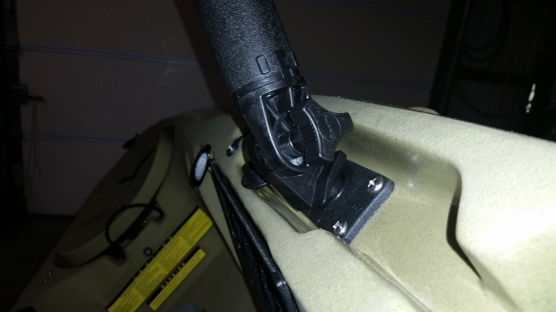

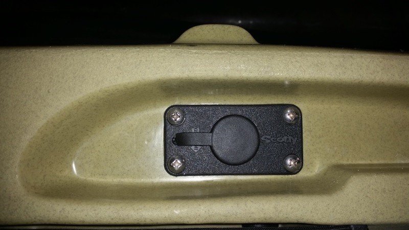

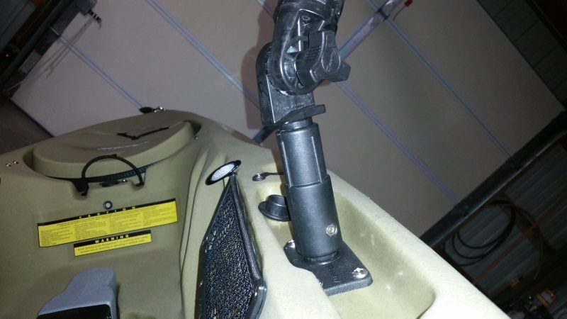

I was able to install a flush mount backed by a 441 Backing Plate in the trays (one on each side). When drilling the holes and mounting the plate, had to watch so it didn't interfere with the rudder control cables.
The flush mounts are nice, but there's not a lot of clearance for the adjustment knob, for the tubes I'm using, I can put them at an angle so that they don't rub on the gunnel. I have a mini rod height extender that moves everything up enough if I use other rod holders.
If I were to do it again, I would use a 241 deck mount.
Here's a few pics of my mounts

Awesome! Thanks for the pics. I didn't want to do deck mount since they protrude above gunnel. I want to be able to easily load it upside down on my rack.

Finished install with Scotty backing (had a difficult time with the backing screws/nuts)
Used bungee to keep rudder lines out of the way while drilling holes

hope this helps! tube is touching top of hull using slip dics
