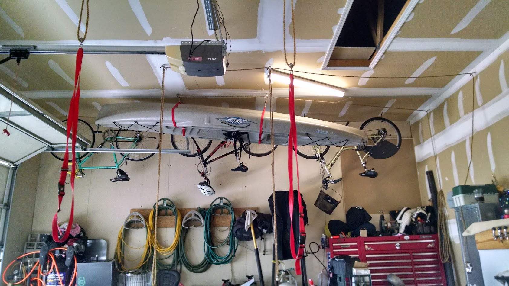

I went homemade with mine to hang 3 outbacks: 6 single blocks, manila rope, a number of screw-lock claps, and the webbing to hug the kayaks.
Pulls up pretty easily, the manila doesn't bind/curl up like the poly I used before, and the webbing cradles the Hobies with no harm, year 5 or hanging like this.
