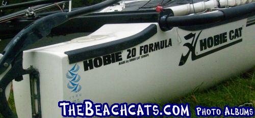

There is an album with pictures of a European "Hobie 20 Formula" that has the small wing racks that are available. Only ones I've seen pictures of. I have a Hobie Europe "wing brochure" some place that shows the three kinds of wings available.
http://www.thebeachcats.com/gallery2/main.php?g2_view=core.DownloadItem&g2_itemId=35775
