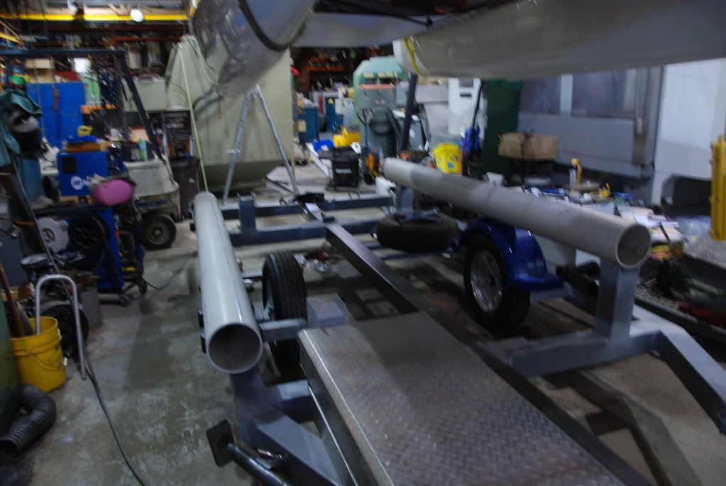

Dad and I pulled the our sc and all the gear out of the shop and started looking at how to put this mast up. I'd read the manual 4 times that morning and figured, "hey I'm a pro, No worries!"
after some knot tying and cursing we hauled away...about half way up the stepping pole started shifting in its socket. We didn't like the look of things so we let it back down and went to lunch.
Knowing what a fiasco it is to fix/replace a mast (1 of my 18's came in with a broken comp-tip)
we decided we wanted a better method. Something a little less spartan and a little more sure-fire. Thus was born the super trailer! We welded up a frame bought REAL trailer tires, moved them inside the frame on torsion axles, used the sail-tubes as guides, built up some roller fixtures and an a-frame to hold the mast in the rear and a winch post in th front. Currently it's assembled about 80%. Now all we do is roll the mast back on the A-frame, put the pin in, swing the A-frame forward, and push the button on the winch. Wholla! with the boat&mast its about 1600lbs+life jackets an outboard and the sails. She's a beast but it works like a dream. we're waiting for the weather to break (currently 33F) to paint and install the lights and toolboxes. You'll have to excuse my pictures,they are shaky And the shop's Super cluttered right now.

Last photo...First thing that came to mind was torpedo launching tubes off a PT boat...don't know why........
Would like to see a pic of the mast hoisting section. Nice looking trailer too.

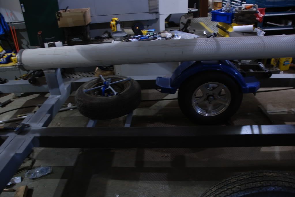

Today was our first really good weather, and that means a shiny new coat of IMRON for the trailer. wiring tonight, then mounting of sail tubes, storage boxes, spare tire, and by this weekend.... the boat! :D (excuse the mess this is the first time we've had the doors up in 5 months!)

This trailer is positively insane! I don't think I've ever seen such a heavy-duty trailer. Don't think I've ever seen "inside wheels" like this either. Look forward to seeing the trailer with the H21 on it.

The tubing looks huge (and it is) but the wall thickness is 1/8" so, it isn't as heavy duty as is perceived. Today we put on sail tubes,winches,fenders, tie down ratchets, outer cable, mud flaps, lights, and some of the roller/rockers. Soon we'll have the tool boxes, jacks, and boat on.
The trailer is built for cross country hauls, Cincinnati isn't exactly beachfront!
The wheels are inside so you don't have to have your ass out in traffic when you get a flat.
If you look at the back bumper you'll see two hubs. in addition to the rolling jack there is also a standard trailer jack pined to the right side of the trailer.
get a flat
unpin the jack
pin the jack in the rear bumper hub
crank 'er up
crawl under boat
change the mag wheel
crank 'er down...you get the idea.
the whole point was with such a wide boat it was going to be tedious, if not downright dangerous to change a tire on the right side.
P.S. I'm looking for some "danger overhead wires etc" stickers for the winch pylon (because thats what you'll see when you'r stepping the mast.) Do I have to buy these stickers or do Hobie's lawyers have them giving 'em away?
